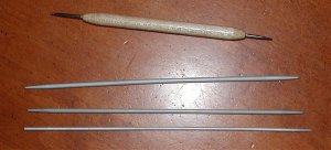

    Scoring
    Like shiftdel, I score from the printed side. I have two favourite scoring tools. Picture attached.
    The first is a small knitting or darning needle that I found at the thrift shop. They come in a variety of sizes. The three shown are about 1.5mm, 2mm and 3mm. I like the 2mm, but the smaller one is handy sometimes. All are about 6 inches long.
    The other (my favourite) is a little hobby tool I found in the scrapbooking section at the local dollar store. Its the one with wooden handle. One end is a rounded point, the other has a small (about 1mm) ball at the end.
    Because the ends on all the above are rounded they don't mark the paper too much, and where it's really prominent I touch up later with watercolors.
    Keep in mind that less pressure is better - you're not trying to cut the paper, or make a deep mark, just to coax it into folding where you want it to. Practice, practice.
    As for glue, everyone has their favourite, but I've observed that most cardmodelers agree that good old white glue is best. I always use Aleene's Easy Flow Tacky Glue. I apply it with a toothpick, and about 10 seconds of pressure is enough to tack something into place. 30 seconds and it will handle some fairly rough treatment.
    Keep at it,
    SJ

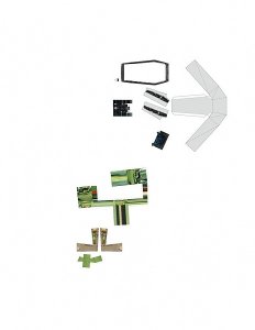

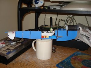

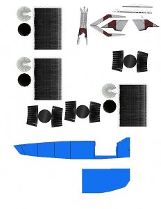

  16. jwhawk04
    jwhawk04 New Member
    Jan 30, 2006
    13
    Working on Viper mark2

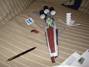

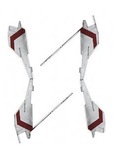

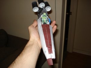

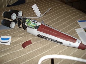

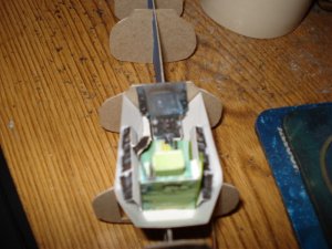

    Hello all sorry for being away so long wonderfull to see this thread has grown. Began work on an updated viper 2. In case I don't finish it before I deploy here are some pics to go by, and the files so far. I need to work on the seat some more it's angle is wrong. Will worry about that when I finish skinning the model. So far all the major structure looks fine, the only major parts left are the aft wheel wells and lower cooler ribs. I am working at 160% scale of the files attached for a length just shy of 15 inches
