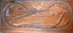

The Photographs never lie...
This is a 'satelite photo' of the entire layout.
MilesWestern

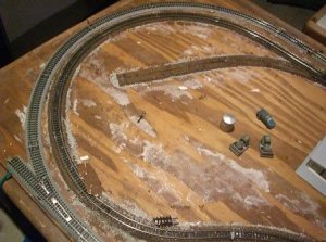

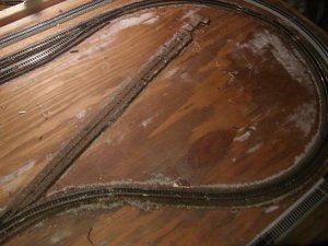

As you can see, the spur tracks aren't laid yet, this is would like some advice on.

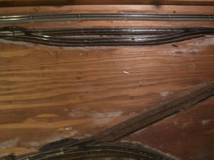

Triplex
There's nothing there yet that I (or anyone else) would call a yard. The layout definitely needs more spurs. Build the spur in the corner that you're clearly planning to. I also suggest making one of those unlaid spurs branch into two - the resulting tracks won't be long, but they'll allow spotting cars at different locations. For switching that isn't so convenient, put two industries along the same spur. Or make one into a a switchback.
MilesWestern
If you look at the overall view of the layout, the spur on the left will become a four track yard. This is the "Eastern" terminius of a MYTrak layout. My trak is like Ntrak, but built to standards that my friend and I set up a few months ago.
I have some questions however.
-Should I include and "escape track" for inbound freight locomotives in the yard?
-What industry Ideas might you have for trackage on the right side of the layout?
-Would this track better be hidden with buildings, or scenery? (I cannot find a reasonably good location for a tunnel, keep that in mind)
- should there be a spur off the siding leading to an industry?
-How can I integrate my inner/outer main operations? (like passenger/freight?)
If you weren't going to add any more space, I'd suggest building a small yard off the passing siding, and adding a spur in the space between the outer and inner tracks at the top.
webmaster
If you didn't want to many buildings in the center, you could always put a switchback in opening up in to a larger multitrack yard.
