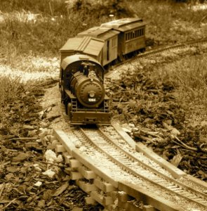

    Hi Tyler,
    Glad you liked the pictures. Model RR photography can be a hobby in its self.
    Here is another shot of #1 drifting downgrade that I did with the "sepia" setting on my old iMac computer.

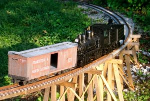

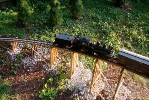

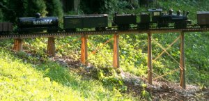

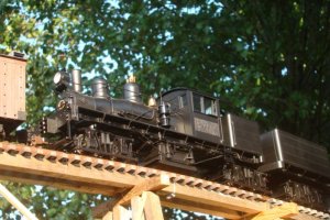

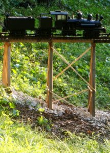

    Nelson's Gap Trestle does not fall down.
    Well it has been 104 degrees on the train shed thermometer today and way too hot to work so out came the camera for some in the sun shots of the new trestle spanning Nelson's Gap on the Little River Railroad a logging outfit in East Tennessee.
    Since I got my fancy R/C Battery converted Shay back from the shops I was quite pleased that the bridge did not fall down under its weight. This being my first attempt at Large Scale Bridge building and all.
    The highest bent is 22" from ground to stringer. The trestle is built coming off a slope with a 1.5% uphill grade to easily pass over trackage planned for in Nelson's Gap. 1:20.3 scale requires clearance of at least 12-14" from railhead to overhead track to allow a train to pass.
    The curve is 10 foot radius (20'diameter) and had to be factored in to the grade and the trestle design. This has been a real relearning of geometry for me.
    The repaired Shay now has about a 25-30 foot radio range and much better sound with a "crisper" sounding chuff and whistle. The exhaust bark even echoes off the back of the house when the train is pulling a grade ......very nice.
    Hope you all like the pictures.
    Doc Tom:wave:

    The Beast is back!
    it is looking good Tom! did the Shay get a bigger speaker?

    Beast spotted near Elkmont
    Hey Bill,
    Thanks for the positive feedback.
    No the same speaker is in place. Don Sweet after learning of local disastifaction with the sound downloaded the 35 ton Shay sounds from the Phoenix site and loaded them in. He then spent a lot of time with the brass triggering mechanism inside the the 3 cylinder motor to get each cylinder stroke to chuff separately. He did a good job and there is a definite improvement with a very clear sound and not the muffled drone it had previously.

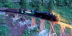

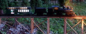

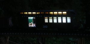

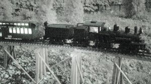

    Night Time on the LRRR
    Night Time on the Little River Rail Road

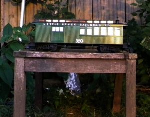

    The boys took LRRR Combine #310 down the Southern RR to The Dead Grass Crooked Creek and Western to visit Mr Bill Nelson in the well known DGCC&W car shops.
    The shop crew under the watchful eye of Mr Nelson repaired the aging wood combine and repainted it in a beautiful green varnish. New hardware was applied to the car, bringing it up to 1923 RRA standards.
    The car shops removed all the kerosene lanterns and in a few decades these will be all the rage in the Tennessee antique shops. New fangled electrical lights were installed and management and the traveling public are really enjoying the improvements.
    Here is a night time shot on a hot Tennessee night as Combine #310 takes a few travelers and empty gons upgrade to Elkmont. The new lighting is very visible as the train crosses Nelson Gap trestle. Who knows what further improvements await the Tennessee mountain folk.
    Doc Tom:wave:

    The man and dog behind the baggage door made all the work with the LED lights worthwhile! it is just a shame that this car is 17 years old and has speent too much time outdoors, allowing the window glazing to yellow from UV light exposure or the seats would show real well. Oh well I can't complain, Emily and Forrester both played with this car, as did little Joey.

    Glad you liked the pictures. Did you catch that the last one was done with a "night vision" infrared technique? Of course this was not available in 1923 but did come with my trusty Sony camera and I enjoy fooling with it from time to time. The infrared came in handy as I set up the camera on a tripod. It was so dark that I needed it to get the locomotive in the frame. Then I did the real slow shutter speeds to get the other pictures.
