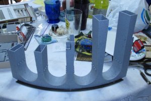

    Doc Tom,
    I just found this website and thought it could apply to garden railroading also, although I could be wrong. But here it is: http://www.railsystemsco.com/Groovy%20track.htm
    I thought it was a pretty good idea and almost makes me want to get into 7 1/2" gauge... and I thought my wife yells at me enough now for my trains taking up a small spot in my kitchen...

    Tyler. my dad used a similar system back in the early 70's using extruded aluminum rail with a tab sticking out the bottom of the web. The rail was the smallest available for G at that time, and that and the self gauging in the slots in the ties. The ties my dad had were very nice. the man who sold the track lived near a piano factory, and the ties were made from scrap wood from the piano factory. all of Dads wooden ties were mahogany. they looked really good. there was no good system for rail joiners and hooking up electrical connections to the aluminum rail was a bear.
    building a switch from bar stock is easy. ??? You guys at the club have heard me ***** about how much harder code 100 rail is than code 70. of course a grinder makes things easier I personally , sadly, am not a welder.

    They were comparing the difference in ease between scale sized rail and bar stock in 7 1/2" gauge and larger. Of course that'd be a beast between making switches in a larger scale if you keep thinking small scale, but to me it seems relatively simple. That being said, if either you or Tom has access to some bar stock and a torch, I could braze some track up and maybe a couple of switches. For the larger stuff, though, I would do as the website suggests and weld the loops for the bolts. Of course, that's all up to Tom.

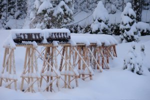

    Fishin at the Little River
    This week the Smoky Mountains have looked like this and not much has been done on the Little River Rail Road.
    Yet, the boys remember when it was springtime and Little Jimmie Smith showed off his catch of Little River Trout to the crew of 2147. Little Jimmie also wondered when the heck were they going to move that locomotive so he could go back to fishing from his favorite river bridge over the Little River.
    Well it seems El Greco ,the brakeman, was worried about a dragging brake line and just had to fix things right at Jimmie's favorite spot. Brakes are very important in a loaded logging train coming down grade from Elkmont to the mill at Townsend. Jimmie must learn patience.
    Doc Tom

    Hey Tom glad to see your progress, you make it hard for me to keep up on here. The snow pic is beautiful & a fantastic job on the trestle. A snow covered trestle dosen't get any better than that.

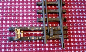

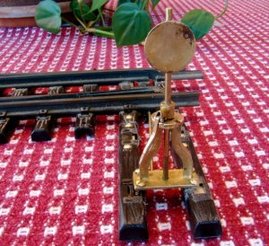

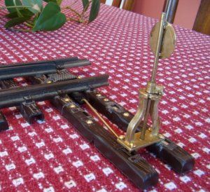

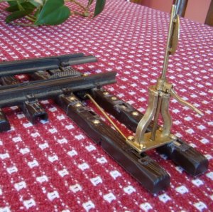

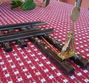

    First operating switch stand for the LRRR
    Many thanks to Bill Nelson and all the nice large scale pieces he donated to the cause of the Little River Rail Road. He gave me the parts of an operating brass switchstand from his Dad's collection that I was able to put together today on a "snow day" (the clinic was closed).
    Bill also has given me a very well made LGB turnout from his Dad's old RR.
    First step was to remove the electrical motor from the turnout.
    Second step was to fashion long ties to mount the mechanism for the switchstand.
    Third the brass stand was assembled and mounted using a brass rod to serve as linkage.
    Fourth step will be to clean up the turnout and stand and paint the track, switchstand and target.
    The switchstand does work just like the prototype as you can see in the pictures.
    A lot of fun!!!! Thanks Bill.

    I love that pic of the snow on the trestle, reminds me of stuff I'd see back home. Maybe you should have a removable snow plow on the pilot of the Shay to clear the tracks... that'd be a interesting concept.

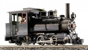

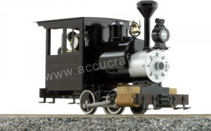

    Here is a photo of the "entry level" "RUBY" (made by Accucraft) that is supposed to be the best way to start out with live steam in the garden. It can be purchased for less than $500 on eBay and some of the discount sites.
    Here is also a picture of Accucraft's "Plantation" engine in 1:20.3 that I also really think neat. It too is live steam and reminds me of my Haitian Sugar Rail Road.
    I think what might be my first live steam will be the Ruby and then a conversion of it to a 0-4-0 with a sloped back tender to model the real Little River Rail Road #1.
