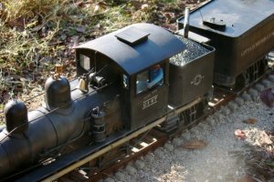

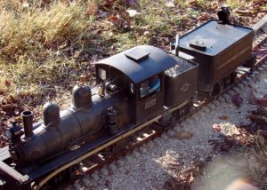

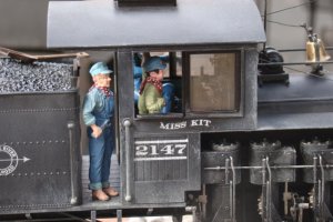

    It looks good Tom. did it det some dull coat or something, I don't see any shinny plastic look there at all anymore. Much better.

    Dull surface and more Piccies
    Hi Bill,
    Glad you like the look. I was actually thinking of our previous discussions regarding 1920's logging equipment and locomotives. We talked about used rather than abused in respect to what the locomotives looked like in the 1920's. My LRRR is set about 1925. The builders plate on the Shay says "July 1,1917" so I set my mind to limit the rust on an eight year old locomotive. A review of several websites on weathering reported that heavily rusted locomotives were rarely in service (always exceptions I know) and were more than likely sitting on the scrap tracks waiting to be cut up. So rust on this locomotive is only seen on the couplers ,a few of the NBW's on the pilots, sparingly on the trucks and on the fire box.
    The decals were over sprayed with VALSPAR transparent dull coating from Lowe's (Probably the same stuff as Dull Kote). This was then followed by my dilute alcohol and india ink wash. The AI kills the sheen of new plastic and some of the starch (which makes Dull Kote dull) in the over spray is precipitated out giving the overall dusty look.
    Very carefully I dry brushed the trucks with a mix of light gray, white and a light brown.
    Because this beast is so big all this took place over a 10 day period.
    Here are a few more piccies of the "wrong side" of # 2147. Note the water siphon hose.

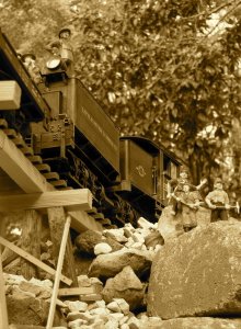

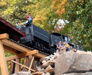

    The Trestle at Straka Falls
    Down grade from Three Prongs the Little River Rail Road crosses a small "holler" fed by the creek at Straka Falls. This is the second trestle Boss Crumb and his boys have had to build for the line. How many more???
    Well, for now they are taking a break and posing for some pictures of their creation.
    Hope you like the pictures.
    Doc Tom:wave:

    nice bridges Bill and Tom, are any of them going to be over water courses? or was Tennessee in the grips of a drought in 1925?

    looking good!
    Mighty fine work Tom, and them is some good looking rocks!

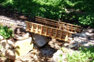

    Water Courses
    Hi S class,
    Glad you liked the early trestle work. Yes the Little River itself runs through the center of this garden layout. Here is a picture of a bridge across it upstream.
    I hope to save up the $'s to put real water in it in the future. I don't recall a bad drought in Tennessee in 1925 but there sure is one now.
    Instead of making furnace filter and polyfiber model trees like I did back in the HO days now I have to daily water the dwarf Alberta Spruce to keep up the green look.
    Praying for rain here in modern day Tennessee.

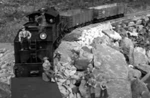

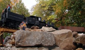

    Thanks for the rocks Bill and Dave
    Hi Bill,
    Glad you liked the pictures. Thank you for helping with the rocks from your farm that are being put to good use building the mountains of the Smokies in Large scale.
    Dave Straka was by the other day with a pickup load of rocks and fill for the mountain. Hence the name of Straka Falls for this second trestle. As you know the first trestle crosses Nelson's Gap in honor of your tremendous help.

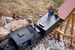

    Here is another shot from today's photo session with "Pee Wee", Larry and Ernie the brakeman up in the cab of Shay 2147 keeping an eye out for danger on the mainline.
    Doc Tom:wave:

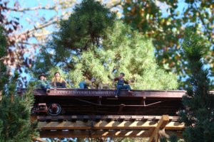

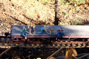

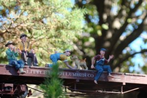

    New flat car and new spruce trees at Nelson's Gap
    Hi
    What a beautiful day outside today in the Smokies in Tennessee!!! My road crew was really goofing off and enjoying the three new dwarf Alberta Spruce trees up at Nelson's gap. They really got laid back on the deck of the new Little River Lumber flat car and had fun with a harmonica, pet dog and some interesting concoction in a can that lead to interesting behavior high above Nelson's Gap. Fortunately no injuries, and the crew will sober up and go back to work again this Monday.
    Doc Tom:mrgreen:

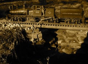

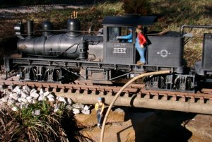

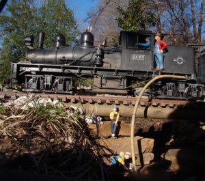

    #2147 gets a drink from its Siphon Hose
    One of the things that is pretty neat about large scale railroad modeling is all the detail parts you get to play around with.
    The Bachmann Shays come with a rather nice flexible siphon hose that hangs on the fireman's side of the locomotive.
    I decided to set up a scene showing the crew siphoning up water from the Little River to fill its tender. The locomotive is parked on a log bridge and the hose has really got to stretch to get down to the low summer waters of the Little River.
    Hope you like the pictures. Tom:wave:

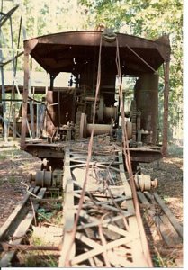

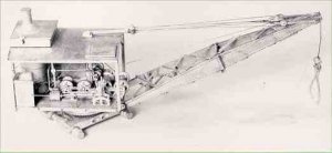

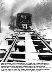

    Hi Tyler,
    HAPPY NEW YEAR. We all are missing you and look forward to when you get back to Clarksvegas.
    Large Scale Central is a forum I have joined to get help with building the Little River RR out in the back yard. So far they have been a very helpful and friendly bunch.
    Here are pictures of an American Hoist and Derrick Log Loader I would like to build in 1:20.3 scale. Bill N. has graciously offered to help with its construction. As you know Bill has done a lot to get this RR going as well.

    Doc Tom,
    I've seen this sort of contraption before, can't recall where though. That would make for a very neat project and knowing both you and Bill's handywork it'll look (and maybe even work) fantastic. Are you planning to make it operable somehow?
