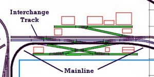

This is what I had using the RTS HO library and doubling the dimentions to simulate N. Then I downloaded the RTS N library and the whole thing went out the window.
The buildings I have to use are:
DPM
Goodnight Mattress Co
Gripp's Luggage Co
Trackside Transfer
Con-cor
Appliance warehouse
a small factory building of unknown mfg. and
other structures that I had planned to scratchbuild.
The buildings on the diagram are just random structures that I planned to either buy or scratch build. I have approxamately 4'x2.5' available for this area of the layout.

Clark,I have a question if you don't mind..Those 2 switches on the bottom below the crossing may I ask what they are for? Curiosity got the best of me so I thought I would ask.:D
Hey Larry,
Not to answer for Clark, but I would say that the little switcher,
which is used to position the dropped cuts for loading or
unloading at the two industries, is parked there between the
switches. Would this work?:) :) :)
It also lets a car to be picked up get pulled off the siding so
another can be dropped off.
If that crossing were a double slip the switcher could manage
almost any kind of move!! (without having to run around on the
main) :D :D :D What do you think??
Surely there's a prototype fer this somewhere!!!

No Y
Hi Larry. Cid is basically right. I added it just to give the switcher some more flexability when delivering/picking up cars from those two industries. The question is pretty much moot since none of that is working now.
