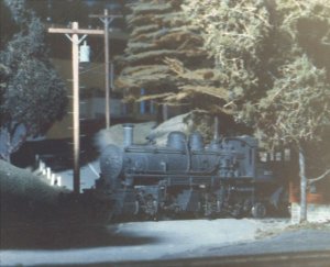

Pete, That photo is great! The pole is very nice. Did you make the transformer or is it detail part? The trees are great, the overall composition is great as well. Love the shadow over the nose of the loco.
Gary

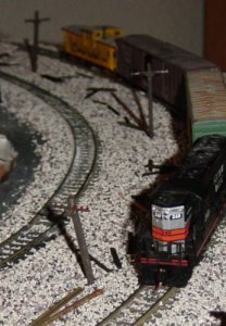

I model in "N" scale and just used toothpicks and some crossarms from (I think) 'Depots by John'..then painted the insulatiors...will try the small seed beads (from "sig others" hobbycorner)..then planted them along the row, low and kinda crooked because that is what I see around this part of the country..still need more weeds and stuff to fill in but like the way they look......
