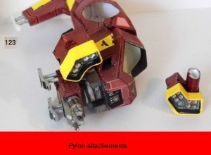

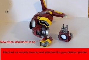

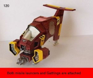

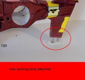

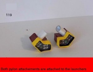

And now, to follow up on more photos of the build. The last photo in the build process is 206 so there are many more postings to go. For some reason, the photo sequence is off so I numbered them. Enjoy and see you all next posting.

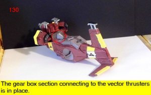

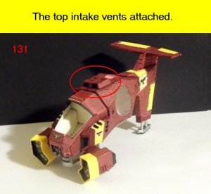

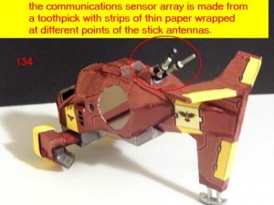

So here are a bunch of photos of the build.

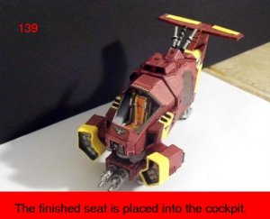

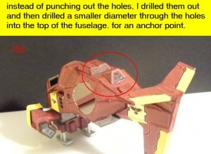

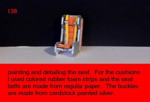

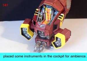

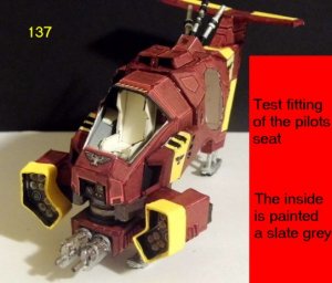

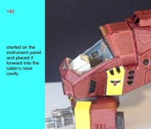

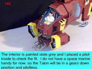

Still more photo updates

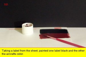

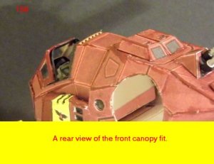

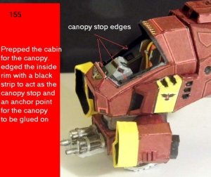

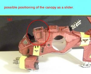

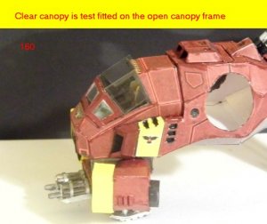

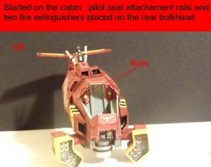

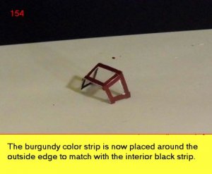

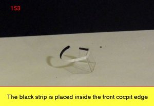

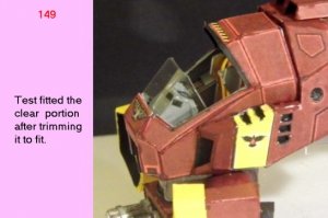

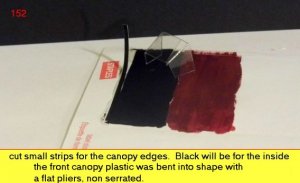

Now with the Talon This bunch of photos, show my sticky label method. It also works well with rounded canopies. The paper sticks very well and gives a good adhesion point to the canopies. In this case, I used the flat panel from the pastry case. The plastic is thick enough to allow for a bend. I use a plier that is flat and no ridges so that it will not mar the surface. Once it is bent in the position required, it will maintain its shape and you do not have to worry about it spreading outward. The canopy in the plans is not together so I cut it out and joined it as one whole piece. This allows for a better fit. Without further Ado, here are the pics.

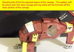

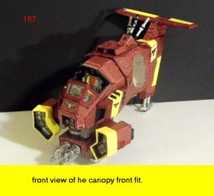

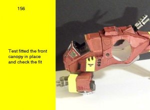

Continuing with the updates. I have to post them six at a time.

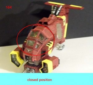

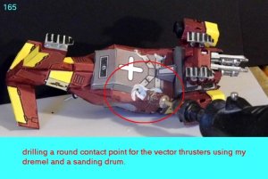

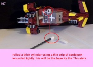

Here the last set of photos for this session. I have to edit a bunch more and be back soon with the missiles and bomb hard points.

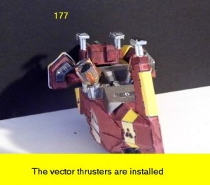

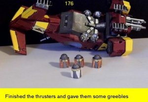

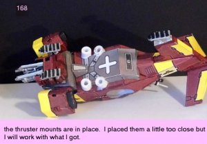

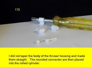

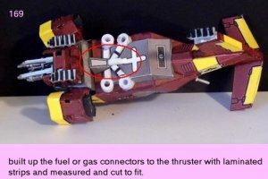

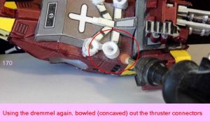

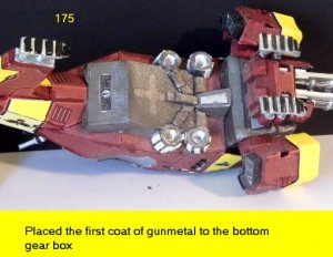

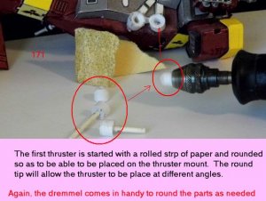

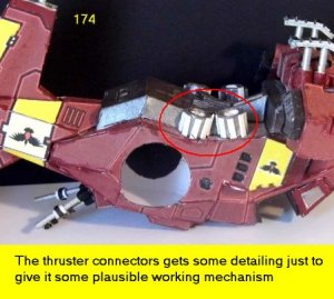

And now for a bunch of photo updates on the talon. As you can see, I re-did the vector thrusters my way. I had a hard time lining up the originals so I made them into two sections and rounded and concaved the connectors so that you can pose the vectors in any direction.

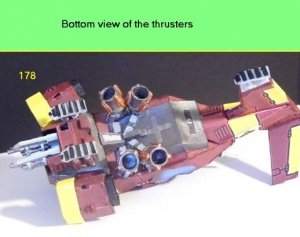

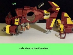

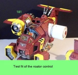

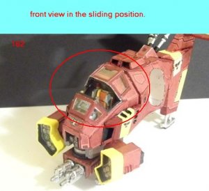

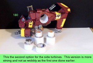

More photos, I wonder if the mods (Zathros) can adjust the uploads to a higher rate than six at a time? I deviated from the plans again in the making of the thrusters. This version is very sturdy and they rotate the jet pods individually.
