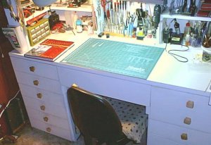

Several years ago I worked a deal with my old boss. I worked in a carbide saw shop that did work on cutting equipment for the furniture industry. I had one of our customers make this bench for me to my specs. This would have been very expensive but I spent 2 days making 2 special saws for them on my own time and made a trade. Trust me when I tell you, buy the drawer guides. They are well worth it.

Blake
Those who can't make there own have to bye them. What do you suppose was done befor you could just go out and bye hardware. There is also a satisfaction in doing it yourself.
If a drawer was going to be opened thousands of times then mabie it would be worth the investment in drawer slides, like in a kitchen. But for basic storage I don't see the drawback with the system I described, but I'm just passing on the idea. It must work or else they would not have published it.

I guess they would work okay, however, my experience with slides like that is binding in humid weather. Also, hardboard has a tendency to come apart after a while. As much as I like my workbench, it is made of hardboard covered with Melamine. A few of the drawers have come apart and have been repaired. Gary Pfeil made a workbench modeled after mine. I think he used plywood for all of the components. The drawers in his bench bind a little but for the most part, work quite well. But, you are right, if you want to buy something as opposed to building it, the cabinet you described would probably be sufficient. By the way Trainclown, your avatar cracks me up and I like the fact that you "lay track funny". Do you know why cannibals don't eat clowns?
