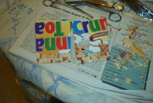

I don't know if I invented this method, but I have never seen, heard, nor read of anyone else doing it, so I guess I did invent it. I glue cedar bedding (sold at WalMart for pet bedding) in rows after I cut it to size. It's a time consuming task and can only be done one row at a time. Each row is sandwiched in an old phonebook with aluminum foil, so it wont stick, and allowed to flatten and dry. It takes an hour or so a row to dry so it's a couple day process. The small areas that seem to be missing are filled later with fine pieces. And yes, it's a cereal box. Dash10

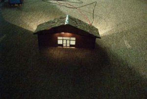

I also installed lights as I do in most of my structures. This is my first attempt at "night" photography and am suprised my digi cam does so well in low light. I seen Robin's photo of his church and it gave me the idea to try it, so THX...DASH

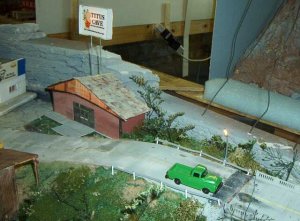

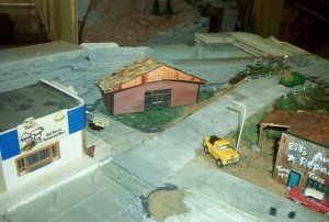

I installed the sign for thr tourist trap and added some walks and did some scenic work. I have also started the wires for the mountain. I'll need to get the backboard in place before the mountain goes much further. DASH

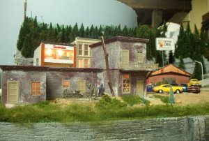

Here's an image from another restful spot on my layout and shows how you can sometimes get away with using Xmas houses for background buildings, at least I think they look good. DASH

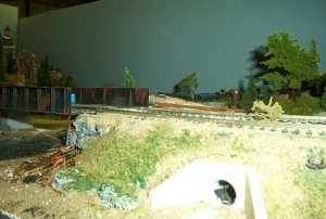

My 1 hour today was more like 2. I cast a garden yesterday and today I carved, painted, weathered, and planted it. It was so much fun I'll have to stay a little late tonite to catch up on the paying jobs. I was going to put some people setting on it, but they are either glued down or not painted, so that will come later...DASH

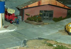

12-4-2003
Since my last post i decided to put a (gasp) kit into my module. This is an old ConCor kit that I purchased on ebay for like $7 and put together last winter. It's been setting on a shelf since. My foray into building a modular brick building didn't fare so well, and I like this building so I planted it. Prob. get banned from this forum over that, but...:eek:ops: I put one of my "trinkets" in the court, better there than in the curio. I also started hard shelling the background mountains. -x

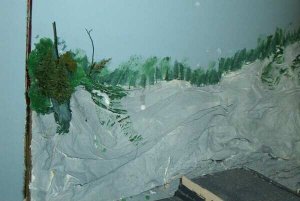

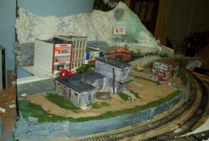

Hard shell done and painted gray n green. Next I drybrushed the background to simulate trees in the distance. Then a row of old used and faded scotchbrite triangles are glued on. Then rows of trees and ground foam. As the trees go down they get bigger. I need to go buy more trees. DASH

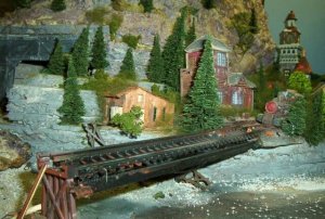

Trees came in
My trees finally came in and I installed them. What you all think? DASH
