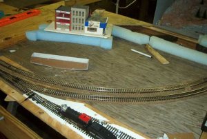

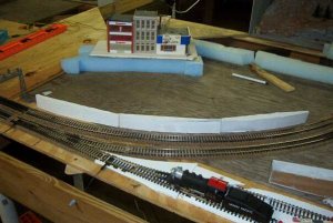

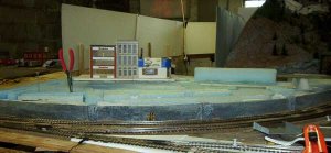

I'm building a new corner module for my HO layout and want to build a long curved stone wall with a town elevated above the tracks with a stratified rock wall and mountain behind the town. So first I made a form from cardboard covered with clear packing tape.

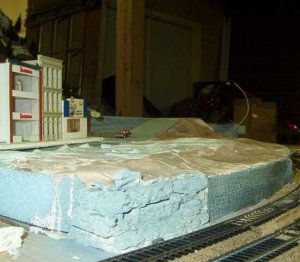

I then started castin wall sections and as they set I nuke them for 5 min and then carve them with an eyeglass screwdriver, my tool of choice.

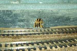

Here's a picture of a casting after carving but before coloring. I'm going to use acrylic washes which is a pretty way of saying watered down paint.

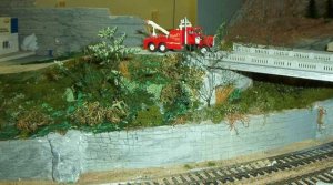

The wall has the pillars cast in place and colored. The motor lines are darker than they appear in normal overhead light. The flash on my camera robs some of the naturally occuring contrasts. I like my little screw driver because if you want wider lines you apply twist as you pull and the line gets wider. The one I use is the smallest straight blade that come in the imported $2 sets. Next step is to blend the wall into the rock and dirt.

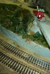

Fred_M

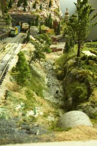

I'm not sure what floral moss is. I first make a mush from 2 oz of whiteglue, 8 oz water, and green paint in a blender. I then add paper towel, McDonalds bags, and newspaper to make a thick pulp which I spread about 1/2 inch thick. I then add turf flocks, home made ground foam, commercial ground foam, green poly-fiber, clump-foliage, caspia, deermoss, lyken, trumpet vine roots, sticks from the woods and yard, paint brush fibers, dirt from the gutter, sand, whatever looks good. I then wet it down with alcoho; based wet glue and wait overnight for it to dry. I like lots of genetic diversity as I think it makes things look better than using a lifelike grass matte or all one color flock. I attacked a pic of another area from my layout that's my favorite so far.

jawatkins
Well, the stuff you use looks great. I, too, enjoy a visual interest in scenery. Well done. Looking forward to seeing more pictures.
MasonJar
It's not rocket surgery
That last picture of the retaining wall is great. The outcrop of rock looks just like limestone. I am going to have to try it. Good work, and thanks for the progress photos!
