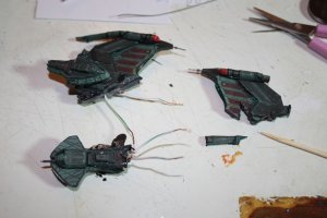

Now that the lead ship is built, it's time to take it apart again:-
The head and the port wing have flickering LEDs inside them - there isn't room in the starboard wing. Three main cuts gave me four large chunks of ship and I then made smaller contouring cuts to the exposed edges. All the internal layers had to be removed to make space for the bulbs. I used my usual method of filling open areas with damage printed paper, crumpled up and pushed into the gaps and cracks. I'm going to leave the port nacelle buckled and connect the rear of the starboard nacelle with a bit of wire. The fourth chunk (not shown) will be minced to make a central debris field and I'm going to try an experiment with a capsule of clear plastic, another LED and some cotton wool to simulate a massive explosion.

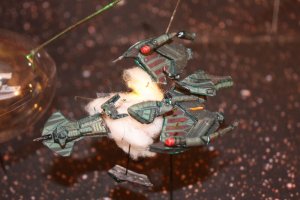

I connected the LED wiring inside the capsule of plastic I mentioned yesterday and encased it in a very thin layer of cotton wool which I teased out a bit here 'n' there. When that was done I joined up the three main chunks with wire and pierced the port wing to hold a stand. The plastic capsule was also pierced to give stability to the fibre optic filament for the Ent-D - I'll be adding an additional filament or two and threading them through to a red LED (yellow LEDs are rubbish for phasers!). The minced central chunk was filled with damage printed paper and the bits were strategically placed before I finished the explosion by scattering tiny pieces of copper wire and metal flakes over the cotton wool:-
And without the camera flash:-

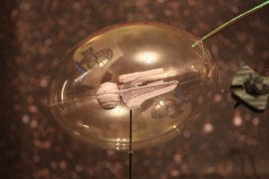

Using the remaining packing I had from my Asterix the Gaul flash drives I was able to simulate the look of the shields around the Pasteur:-

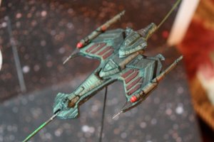

I added an extra layer for the red plates on the top and bottom of the voodieh's wings:-
and also for the green plates on it's head:-
So everything is in it's final position waiting for the Ent-D's phaser to be added:-
