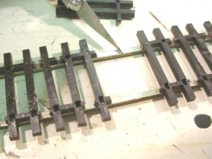

Next, using a hobby knife, scrape off the bottom of the rail to get to good clean metal.

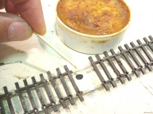

Next, put some flux on the rail where you scraped it clean. (My understanding is that this company uses GERN brand flux)

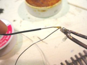

As a disclaimer, I'm going to say that this isn't the BEST way to do the job, but it will certainly work for solder newbies. it worked for me. The best way is doing the rail sides as you have discovered.... well, I guess that is the best way.

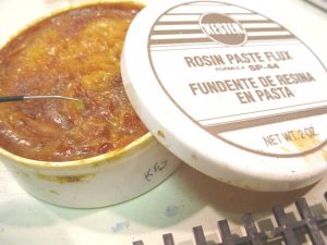

Take some small solid wire and bend an angle in the end, then put some flux on it.
Gary S.
Oct 13, 2005
1,576
Texas

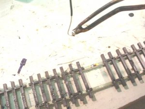

Next, you put some solder on the wire, and put some on the rail. Notice I am using a 100 watt soldering gun. With the rails removed, the extra heat isn't an issue, and actually it allows you to get in, heat up the area, and get out quicker than the little irons.

Gary S.
Oct 13, 2005
1,576
Texas

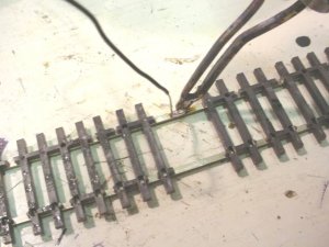

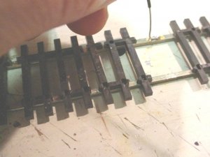

Next, heat up the wire with the soldering iron, let it get good and hot, then press down onto the rail where it has the solder on it from earlier. The solder on the wire will melt into the solder on the rail, then get the iron out of there, but continue holding the wire still for a couple seconds so it can cool.
