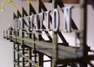

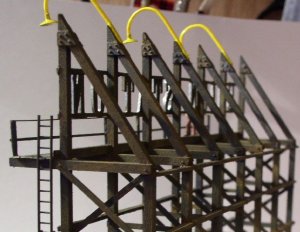

Figured I'd do something simple for my never ending neglected HO layout. Have a Union Station sign and no Union Station. The structures main frame is 12 x 12s. The horizontals braces are 6x12s. The z & x braces are 2x8s. The post for the railing are toothpicks. The top part of the handrail is some 1/2 round plastic .020. The ladders are from my junk box. the lettering is Walnut Hollow monogram lettering from a craft store. The rivet are a combination of Grandt line. The lamp shades are Campbell brass connected to some plastic rod .030. The figure is an long AWOL LPB looking for trouble. The footprint is quite large for a sign but you have to believe in makebelieve! At least I do!
