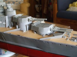

I usually use strip styrene for all of my barrels. It's cheap and very easy to use and paint. Here is a shot of my now deceased HMS Hood (yes, it took a fatal dive several weeks ago :cry:). The barrels were strip styrene.
-Ski

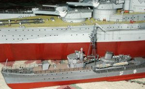

Strip styrene comes in strips and in larger sizes in both strips and tubes. I use it for ALL my mast and gun work of all sizes. You can get the stuff on-line or just about every hobby shop.
These models use extensive use of styrene of various diameters....
-Ski

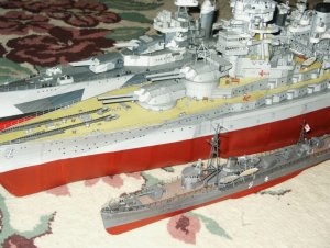

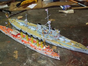

I have always used styrene and paper for barrels 6" or less. Five guns in 1/200 scale look very good and any distance with solid styrene rod and note book paper rolled over the inner barrel to depict the breech end. However i do prefer the turned barrels for the larger mains. They are more scale authentic and relative to the time in labor ar every inexpensive. I used to be a plastic guy and really these models are all but free when compared to the hundreds of $'s you lay out for resin, so buying barrels is a good value considering the hours you can put into a model.
Sorry about the Hood, I just damaged my unfinished Rodney but hope to rebuild her soon.
Shown are the Portland, 8" turned, all others styrene and paper, Nagato's 16 inch and case mate 6" rifles and Kiji, all styrene and paper. The smaller ships really look fine with straight rode and paper.
