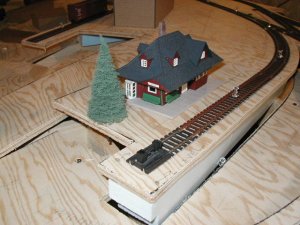

That tree looks like a very well trimmed blue cedar - a tree we often find in parks (at least here in Europe). Therefore it is exactly at the right place beside a stately station building.
Looks really beautiful! Congratulations!

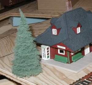

Sorry aart... I missed that part of your post. Here's a close up. I'll still try to add step by step photos later.
Andrew

GAWD MasonJar!! That is a beautiful tree!!! I love trees.... and fine scale modeling...and that is a great tree!! Funny how the simplest little things just thrill me at times. :)
I'm gonna have to try that!! I hope it turns out as good as yours did :D
