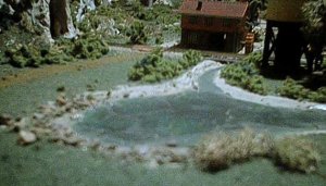

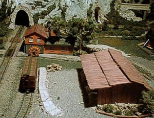

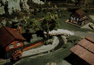

This looks good, Michael!
I love the water in the mill creek - this looks very natural. How did you do it?
Ron
SLOW
Water & trees
Water: I carved out the homosoat board and then I painted the bottom the color that I wanted my pond and stream to be and then I pored a thin layer of polyearthane and let it dry. Then I pored another thin layer of polyearthane and let it dry and continued with this process until my pond and stream was full.

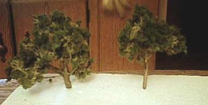

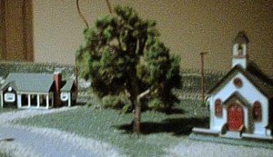

Trees: I pick the trunks of my treas off of my bushes in my back yard. I pick ones that have a natural sort of tree shape to them and then I use a hot glue gun to attach the leachion. And then I mix earth science small brush light green in with the leachion.
SLOW
Earith science
YES IT'S Foame!! I ues it in Trees shrubs, I also use Leachen for tree limbs, I stay with Eirth seicnce. Thay have a have a good product! Pictures come out right! and its instant gradification

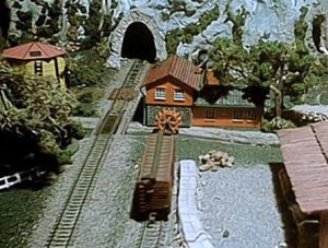

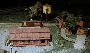

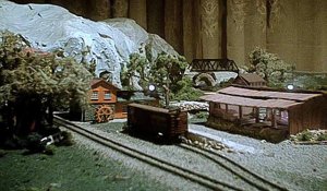

Here are some photos of what I'm working on now...
