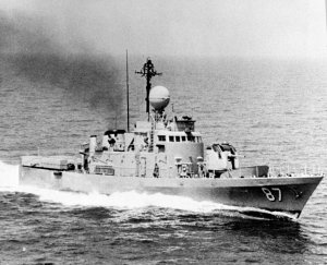

Shalom,
Finding this thread has been an inspiration for me. I served on three similar boats in the U.S. Navy and have often thought of a scratch build because I cannot find a paper kit of the US PGs. The boats I served on were slightly larger at 50M length 6.7M Width and a displacement of 250 tons. They carried a 3”/50 gun mount forward and four SM2 surface to surface missiles aft. A truly beautiful/inspirational build and I have already started my research on the US version.
Regards
Frank

Hello Frank,
Happy to give inspiration for a new model, will be very interesting to follow yours build thread.
If I am not mistaken, the picture is an Asheville typ.
Goog luck with your model,
Shalom Mor

Shalom,
You know your boats, yes I served on the Green Bay PG-101, Marthon PG-89 and the Asheville PG-84.
Regards
Frank
