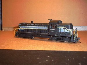

I've done the conversion.
It was a bit of work, but I enjoyed doing it.
I replaced the walkway deck and scratch-built the railings, modified and detailed the pilots, moved the exhaust stack and filled in the fuel filler on the cab.
Marker lights, horns, battery boxes, air tanks and fuel tank were built from scratch.
I also remotored and regeared the original power truck and added constant intensity, directional lighting.

Thanks for the opinions/suggestions so far guys.
Ray, that's a great looking loco, atleast you model the right railroad!:thumb:
You shouldn't have shown me that, now I think I know what I need to do:eek::D
