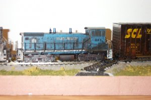

I like to use an eraser myself. Either gum or the pink type. The gum seems to work best when starting out, and the pink for finishing off. If there's lettering around that I wanna keep, I usually mask it off first.
This almost always works great. In some cases there's a little extra wear, but once the unit's weathered it's not a problem. The one time I did have to repaint I got lucky. You can't even tell after weathering.
