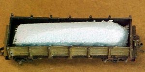

I'm not sure if this is the right forum to put this in, but it is something I whipped up from scratch, & although this particular one is N scale, this would easily work in any scale.
I just built this little car, so I needed something for it to haul...so I thought I'd show how I made a removable load of coal my favorite way, cheap, fast, & easy.
I start by cutting a piece of styrofoam roughly to the dimensions of the car, & then using sand paper, smothing the top into a rounded shape.

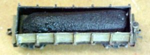

Then I painted it with some flat black craft paint...

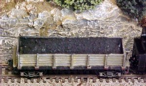

Onto this I brushed some full-strength white glue.
I had picked up a piece of coal of the tracks near my house...I crushed it with a hammer, & sprinkled this onto the wet glue.
I sprayed the whole thing with some hair spray to seal it, & this load is ready to roll.

Charlie that's a great idea! Especially the part about smashing up a piece of real coal. It's my feeling that sometimes there's nothing like the real thing (as Marvin Gaye once said):D :D :D
I tried unsuccessfully to match the colour of our local dirt with paints and finally ended up using some from the side of the road, ground up finely. The price is right and you can't beat the colour match!

Yeah,
I wanted to use the real coal...
But if you wanted to do this, & did't have access to the real thing, you can find commercial model coal, which would also work.
You could also use this technique to make loads of other materials, such as ore, ballast, sand, etc...

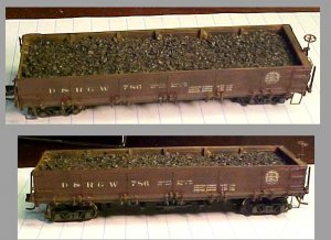

Another Coal Load
My friend Gilbert who worked for NS called me one afternoon and told me to meet him at the local yard and bring a bucket. Seems that a hopper full of black roofing granules sprung a leak.:eek: I got a lifetime supply and they make pretty good coal.:) :D :D

I think either one would benifit from a coat of dull coat. I wonder if you can still get the fake coal made of ground up black glass like stuff. It was pretty good.

Originally posted by cidchase
Good lookin' work, guys!!
BTW Vic,
Ifn' you decorated that gondola, where did you get the herald ???
TNX
Hey Cid, Both ThinFilm and MicroScale have that herald in their D&RGW NG freight car sheets. The Microscale is the stencil version and the ThinFilm is the solid version.
BTW...As best as I know there ain't no prelettered HON3 cars...The one in the pictures is a Grandt Line Drop Bottom Gondola. Although it has a wealth of details due to the extremly high quiality of the kit it was a breeze to assemble.
