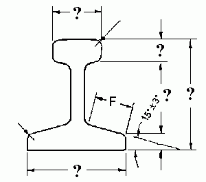

I am new on this forum and also new in modeling... I was searching internet for modeling informations and i decided to make my own HO model. Also i decided that i will create rails by myself (i have some people that profesionaly work with metal...).
I drow picture of the one rail ,so please could anyone edit this picture with dimensions of its parts.(high, widht eventualy lenght...). I found few days ago similar picture on the internet but now i can't finde it. :(

the measurements change from one rail size to another. What size are you trying to make?
Weightin pounds/yard: height in inches
72: 4-3/4"
85: 5-3/16"
90: 5-17/64"
100: 6"
112: 6-5/8"
115: 6-5/8"
130:
150:

But i still don't understand thoes mesures. what are all those numbers , specialy first (like 72:...?)
And i want to make model in HO scale (if this was your question about what size of railroad do i want to make)
jetrock
The numbers (like 72) refer to pounds per yard, a common unit of rail measurement. The number after the colon (like 4-3/4") is the height (from top to bottom) of the height of the rail in inches, based on its weight. All of these are real-world measurements.

NMRA standards for rails
Didy:
Look for the NMRA (National Model railroad Association) web site and look for Standards and Recommended Practices.
All this information (and your diagram) should be there under RP 15.1.
Look Here.
