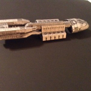

image.jpg I started with a very light, mist coat on this Berserk Battlestar model. & It worked! The pic doesn't really do it justice, but I applied your suggestion Zathros, & started with a light mist & very slowly increased with light coats. The results were much more even & satisfying.:) guess I had been in too much of a hurry before.
Reactions: Sky Seeker
13,498
9,549
Not sure what kind of camera you have, but if usually if you touch the shutter button lightly, it will focus on different points, you can find the point of focus, take the picture by pressing harder, and use the cropping picture in a program, like XNView, to crop out what you want. :)
