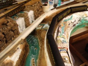

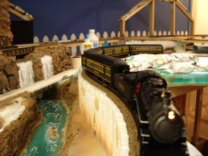

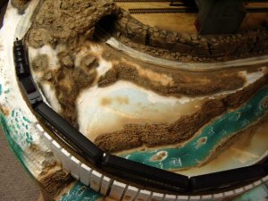

vipe,
Your wish is my command:thumb:
18" curve
Same curve...lookin' down
20" curve
These are 60 footers...as you can see, they are pushing the limits of "good taste" on these curves. Couldn't see going any bigger. They look fine (to me) running around the track.
