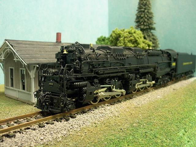

We can't let the steam fall too far down the list so here's something to keep it going:
N scale C&O H-8 2-6-6-6
Key Imports
This is the only brass loco that I have purchased and unless some unique B&O / C&O shows up in the future, it will probably be the only brass on the roster. I was going to build one of these using parts from the Rivarossi Challengers but with the deal I got on this, it was cheaper than buying two Challengers and the value of the time involved in building.
I do have a pair of BigBoy's that are slowly working themsleves into a B&O EM-1 (2-8-8-4).
Tony

skipgear, you're one heck of a modeller...as are msowsun and many of the people on here. I'm looking forward to seeing those EM-1s...I have to take a trip down to Cinergy this week or so..

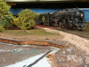

I've been meaning to take new photos of my steam roster to post here but the way things are going it won't happen for awhile. First I was just in a bit of a funk and couldn't rouse myself to do anything on the railroad. Now I've got what started as simple household projects which have turned into nightmares. So for now, two old pics that weren't posted, well one was, but when the Gauge had a problem a couple years ago, a few posts disappeared, this ws one of them. My Lifelike 0-8-0, and double headed Erie berks. Hope you like them.
