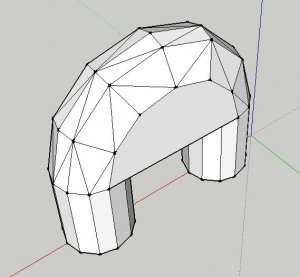

i have attached three pics. Part 1 is of my model. I am a comic book writer, and have NO experience with any of this, having said this, pretty cool model, no?

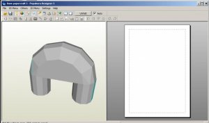

part 2 is of pepakura after i have opened the .skp file. everything looks good to me! what could possibly go wrong? ill just hit the 'unfold' button.

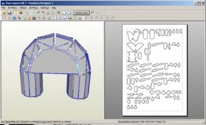

BAM! what the hell? i thought i was making a papercraft not a 3d jigsaw. that is HORRIBLE!
what do i do? what can i do? i really want to have this figured out already!
please help!
If you right click the mouse it will give you a menu there you will find the tool to join up the parts you want too.
that doesnt work, it doesn't recognize the edges as being close together so they wont connet up.
also this would take freaking forever, so not the best solution.

have you tried making this model in another programk that makes 3d models then uploading into pepakura designer? that is waht this program was made for

If the join edges doesn't work it means your original model is made up of independent parts. You need to join them in the 3D before you use PEP3. In Meta you would use the "join closed vertices" command. Hope this helps. Cheers JTF
