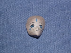

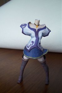

I believe Mizuirogakuen used pepakura for his models and made with or without fold lines. My avatar is Verdandi by Mizuirogakuen and rolled instead of folded. Noname attached is also rolled instead of folded, both printed onto ordinary paper.
Bill

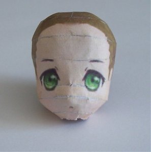

I've made a couple of these models and I would agree with bill, use ordinary paper, i.e. 80gsm. It's easier to bend the paper to get smooth curves and with the paper being thinner the edges don't show up as much.
I started Verdandi by Mizuirogakuen (pic included), but other projects sort of took over. I'm hoping to get back on with it soon.

Now I find it's easier to paint the face after making it... Although this is a bit cheating but that gives the best result for me...

Paul
I've built Verdandi twice. When I built the first one I made the head the same way you are, when I came to fit the hair I had a cursing and swearing job of trying to get the hair tabs to stick. For the second one I left the bottom of the chin off until I had fitted the hair. This made life a tad easier when to fitting the hair, as this gives you a hole to get inside the head to press the tabs of the hair down. Then stick the bottom of the chin on afterwards.
I dont know if it was me but I also found that one lower arm and one lower leg were slightly different diameters than the upper portions. For the second one I rolled the parts into a tube but glued the end tabs into the upper parts before glueing the seam of the tube this ensured that I did not have to fit a one inch tube intio a two inch hole so to speak if you get what I mean init.
Bill
