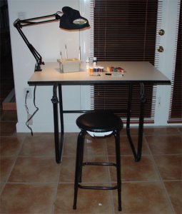

I've decided to try my hand at painting those little plastic folks. My Preiser set of railroad workers have been worked to the bone! Need to start populating my railroad structures with permanent residents!
Thanks to Jon-monon for the link to Brian Fayle's Figure Painting Website. I've taken some of the ideas found here and merged them with what I already know from my days of Dungeons & Dragons 25mm figure painting plus the advice from Warhammer Figure painters world-wide! :D
I will post my painted LPB's to this thread. But first, let me show you my new "workstation" that I set up in my living room for this purpose. It's an old drafting table with my new magnifying lamp ($20 from Staples) and a brand new set of acrylics, fine point paintbrushes and paint brush tub ($20 total at Michael's). I have since added another swivel arm lamp to the other side to provide more light when I am not using the magnifier. Believe it or not, I find it easier to use my own eyesight and only use the magnifier to "study" the model before I begin.

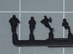

Brian Fayle's advice is to paint the figures black. This will serve as the dark shadows and you dry-brush the color on top of this, careful to leave the shadow areas black. (See his website for details.) This is contradictory to the practice I've learned from wargaming, but I decided to try it out. Here is a sprue painted black with regular paint from a cheap spray can from Wal-mart:

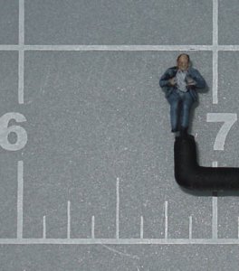

Say Hello to Guillermo ;)
I painted this guy bald and he looked so much like my father-in-law that I just had to give him that name. I am getting a bunch of seated figures ready to populate my next scratch-build - a Wendy's Hamburger joint - and so he's got his white hankie tucked in so he doesn't dirty his nice suit! :D
Colors used: Flesh tone, Cape Cod Blue, White
Washes used: Brown and Black
Total painting time: Approx. 10 mins

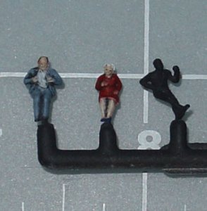

One more...
Hmmm, I'm undecided on this method... From far away they look pretty good, but up close they look awful! The figures are so small that... well, I dunno... what do you guys think? I'm going to try to put them in a setting... maybe that will help me decide.

Anachron
Dec 8, 2003
100
39
Sweden
I still think you are crazy :)
even more now that I know they are N scale
its impossible to paint those fellas :p
