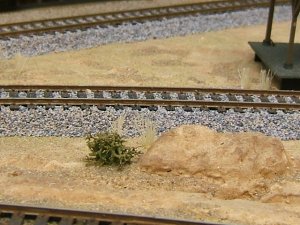

    Here are some prototype photos, for inspiration:
    [​IMG]
    [​IMG]
    [​IMG]
    [​IMG]
    Wayne

  15. doctorwayne
    doctorwayne Active Member
    Sep 7, 2005
    3,845
    Unless you have the curious habit of placing the camera on the layout and shooting towards the aisle. ;)
    [​IMG]
    [​IMG]
    Wayne

  19. doctorwayne
    Sep 7, 2005
    3,845
    Thanks, Kevin. In the first photo, the car on the left is from Williams Bros., and beside it is a 1926 Essex and a 1928 Model A, both from Jordan, while the green sedan on the right is a Sylvan kit.
    Wayne
