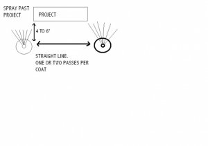

    Its always good to primer your project(especially with white and yellow). Spray a couple of light coats, letting fully dry between coats,instead of one heavy coat.
    I've attatched a crude diagram on the method that I use with good results.

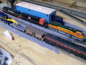

    I've also attatched a pic of two locos that were painted completely with spray can paints, decaled with Micro-Scale decals. The SD70, was a factory paint(CSX Dark Future), that I painted without stripping. The BNSF SD70 was too cool a paint job to repaint, so its on loan to my road.
