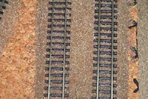

Sounds good Louis.
I tell you what I do, maybe this would give you some help.
1. lay down the track.
2. paint the ties brown
3. paint the track
4. balast the track
5. paint the balast an aged color randomly
6. at some spots add new balast to make it look like new repaired balast
7. paint a wash of rust along the rails
Hope this helps.
Paul
csxnscale
May 9, 2002
273
Belgium
Louis forgot point
8. paint a black line for oil spil in the center of the track.
And pictures say more than words:
Paul

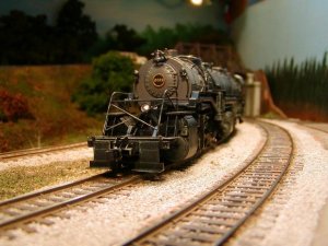

Hi Luis, Regarding painting your ballast a different color, I have to say I've never tried it. The big problem is the ties will get painted as well. I'd suggest that you either leave the ballast color as is or reballast with different ballast. As already stated, ties are best painted prior to ballasting. However, I do not paint rails prior to ballasting. Go ahead and ballast, then you can add color to the glue mixture you use to fasten the ballast, this will weather it. Then I use a small brush to paint the rail sides. I don't find this particularly tedious, but to each their own! As I stated, I use full strength Pollyscale, mostly roof brown. I use some grimy black and rust randomly. Remember there is no right and wrong here, you will find what pleases you. When the rail sides are done, I thin some roof brown (with some rust added in varying amounts) about 50/50. Play with this ratio till you get it the way that you want. The idea is to apply it so that it runs off the rails onto the ballast, but subtly. I am sorry I cannot take a photo to show you for the next couple days, but here is one I took a while back that shows some of what I'm talking about.

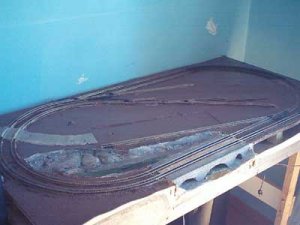

I removed the ballast. I was able to remove it with some warm water. I also remoed the grass, Because I'll be putting new grass with a static grass aplicator. It looks like one hair drier.
I also painted the base with a earth color ink, so taht I could hide some errors i've made. I think it will be even better, with these holes I've made sub roadbed.
Here's a pic:
