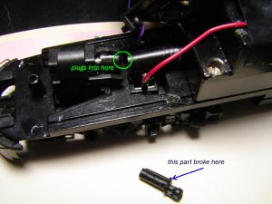

Driving the E8 'round the layout this morning and suddenly there was a grinding sound followed by it slowing to a crawl. Upon closer inspection I found part of the front drive shaft had snapped off and was laying there just spinning. I've included a picture for your viewing.
Anyone got a part number? I can write LifeLike and maybe they'll send me one. Until then the E8 must be shelved - sniff! :(

Looks like you need P/N 584112, Worm Gear Pkg, contains: bearings, washers, worms, U-joints male and female drive shafts, splines. They do not sell the drive shafts separately.
Hope this helps. I do have access to a scanner now and I can e-mail you this manual if you wish.

TA DAAAA!!! There you are, Marty!
Oh boy.... the whole kit, eh? Well at least I have a part number and can send them a little note and ask how much.

One of the fellow club members in the modular club I belong to here in So Cal mentioned at a recent meeting that he had a p2k Alco P.A. making a lot of noise. He took both of his P.A.s apart and found the gearboxes on one of them so over oiled that it was dripping. The other unit was completely dry. He immediately took apart the rest of his p2k locomotives and found that half of them showed no evidence of any oil in any of the gear boxes. Aparantly lifelike's quality control with regard to lubrication is spotty at best. That drive shaft may have broken because of a stiff unlubed gearbox on the truck.

Since the drivetrains of the P2K locos are basically built from Athearn parts, replacement parts from Athearn should fit. It looks to me that what broke is called a 'splined coupling'. If you can measure the length and compare it to available lists, getting replacements should be easy and fairly cheap.
I found 3 different lengths of shafts available at Cascade & Pacific Shops with 12 in a pack for less than $4.50. Click on their 'Storefront' and choose 'Athearn' and look for the ones you need.
The part numbers and lengths I found are:
34025 - 7/8" spline
34217 - 1" spline
40015 1¼" spline

I'm not so sure that all P2K drive parts are interchangeable with Athearn. The ones I have seen were similar in design to Athearn, but not exact copies of the Athearn parts. The axles are the only parts I have seen that are drop-in replacements. Go to the Life-Like website and find the phone number for their customer service and give them a call. I got replacement wheelsets from them in about a week.

Last night I wrote LifeLike requesting information on the part I need. This morning I heard back - more specifically from Shawaunna in Customer Service. She's promised to send out p/n 584112 right away. That's truly good C.S., and is the 2nd time she has pulled me from the fire.
