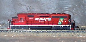

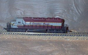

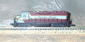

I haven't done any scenary since i was last here but at the "Great Edmonton Train Show" here in Alberta i did pick up a few new locas to add to the fleet.
1 is a Atlas GP-35
2 are Kato Sd-40's the Burgandy and grey is correct type but the red one is supossed to be a SD-40-2 but to most modellers including me we won't know the differance.
Does anyone know how i can check to see if i can equip them with a decoder for DCC.

I have four of the Kato SD40s (first run Road # CP5556) and they will have to be milled to accept a standard N scale decoder. The alternative is that you can fit the smallest Digitrax Z decoder in the rear of the unit if you are willing to dispense with the rear light board.

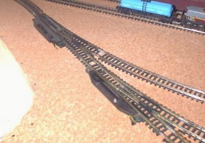

Looks real nice, coming along smashingly. I'm curious about one thing: why did you switch from #4 to #6 turnouts in the yard leading to the shops?
Good question,when i first laid the #4's i didn't try running aany engines thru the turn outs.After soldering and wiring and nailing i ran my GP-7 thru the turn outs and the the gaurds on the front and rear of the engine caught on the electric switch motors.So I needed to replace them with a #6 for a more smoother run thru the turn outs.
And thanks for the compliments, I hope to get a little further over the holidays.
