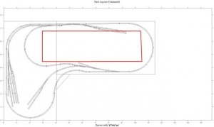

A little help.
Its been a while, sense ive messed with my layout which sucks, I became over whelmed becuase this is my first layout. On top of that I work in the tree removal industry im a climber, im only 19 so its a fun job I actually like it lol, but tree work is slow in the winter months, so cash has been limited. Enough about my self lol, onto my little problem, ive decided to go with a slightly smaller layout, and ive got a pretty decent design drawn out with xtrak cad. But im looking for some help. In the picture below, I cant figure out what to do with the space indicated by the red box, that spur can stay or go, but im just looking for some idea's. All of the curves, are 22", becuase I want to run my larger 6 axles, but if possible I could go with smaller radius's on the inside and use some 4 axle's. I'd like to get some industries in there, hell I dont know, see what you guys can come up with. Any idea's or suggestions would be awesome. Thanks guys.

You know that you can always do your layout in sections and add them as you go. Like the yard now, [tough part so do it early and get it out of the way or wait till you have more experience]. Or do the mainline run now. Either way, look at it in pieces rather then as a whole and it will not be so over whelming.
I hope that helps. :)
OnTrack
Sep 24, 2006
89
Amelia, ohio
you know what, ill take your advice ill go ahead and start slowly, and leave that middle part for when it needs to be done, thanks.
