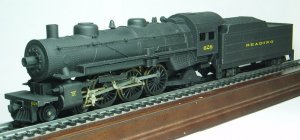

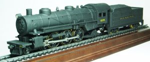

    My John English Pacific
    My John English Pacific ( one of two )

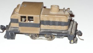

    including some old stuff. I haven't set out to collect old stuff but stuff happens. the first picture is a side rod diesel . Back in the 60's a friend of my father saw my layout, and later brought me a box of stuff. He had been a very early Ho modeler. Most of the stuff was too crude to be of use or even interest. but this little locomotive became the only diesel to ever be painted in my RR's colors (reporting marks were never added to protect the guilty).
    It ran , and well , until a few years ago when the motor died. The manufacturor is unknown, and I have seen two or three others, but they had varying deregres of ZAMAC Cancer. This locomotive preceeds NMRA standards, and oddly has scale wheel profiles. because of this it tended to fall in the flangways @ switch points, as the tread wasn't wide enough to span the gap. I had some dual gauge switches once that I had acidently built the standard gauge flange ways to HON3 standards. other standard gauge engines bumped through those switches, but his one didn't. I am currently searching for a good way to replace the motor, and since the frame is thin, considering narrowing it to HOn3, where it would be happier, due to Hon3's finer wheel standards.

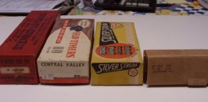

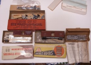

    The two of the kits I bought at swap meets with the original intent of finnishing the partly built cars, but resisted when I realized how old the kits were. The ore car doesn't fit. The O scale car is an ammazing kit. I'm studying it with the idea of scratchbuilding some similar cars, if I could ever find an O scale Rivarossi Genoa.

    Bill - that little industrial diesel is the Robico/Lindsay "Stubby", the prototype of which was built by Vulcan Iron Works (represented in Walthers' Cornerstone series of structures) for operation in the Brooklyn Navy Yard. The model dates from the mid 1950's and was one of several tiny industrial gasoline/diesel locomotives uniquely offered in that period. Incidentally, the smallest of them was probably Penn Line's "Midget", which purportedly could run on an incredibly small circle of track where the rim of a .25 cent piece served as the inner rail of the track loop!

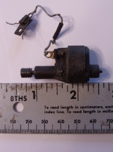

    I was disappointed when I found out it's motor died. The end of the motor is a little cylinder that clamps into the frame. I'm going to have to disassemble the motor, use the end of the frame and the armature, so I can clamp the shaft and gear in the frame to get the right spacing in the worm& gear. I have a tiny can motor that will fit, but I'm going to have to link two shafts that are not parralell. I may have to resort to some kind of rubber band transmission.

    Bill post or send a photo of the motor next to a ruler to give a size referance. Maybe someone can help.
    frank toptrain1@aol.com
    Bill I looked at stubby info and the only motors like that that I have are in two Alco PAs that I have and they are used and running. I will ask around.
    * Also after Lindsay stopped making trains Kemtron started making that little diesel. It was in the Walter's catalogs for a few years as Kemtron.

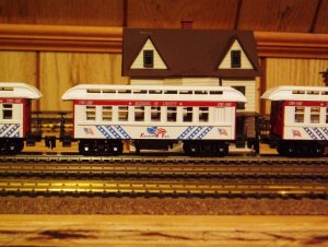

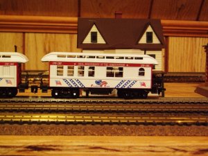

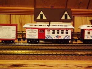

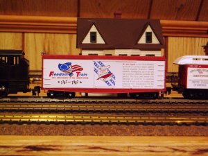

    MDC 36' Old time passenger cars
    Here is the 1987 Freedom Train set. I don't have the full baggage.
    frank

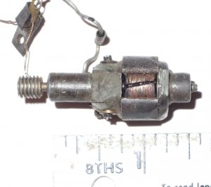

    The stubbies motor!
    took me a while to find the stubbies motor. I have a lot of project trays that can be stowed in the closet when clearing the workbench for a different project.
    Naturaly , the motor was not in the locomotive shops tray, with the two disassembled Brass Consolidations (an NWSL Sierra 18- which is an odd creature with tiny little drivers, and isn't much larger than a mantua 4-4-0, and a fine looking PFM MA & PA engine. The Sierra unit was getting re shopped after thirty five years service, and the PFM unit has just recently landed in my posession from the collection of a freind who had gone to O scale.
    In any case the motor wasn't there, as that would make sence, it was over in the car shops tray with about ten Plastic truss rod flat cars that look like they are decendants of the old AHM flats.
    These are in the car shops to get KDs and new better wheel sets, and get converted to log cars (ading rails to the deck for a barnhardt loader, and bark debris.) as well as a stack of Titchy train group wooden Hoppers, that are getting built moddified into narrow gauge cars.
    Here are the pictures. I'm not totaly given up on this motor yet; I have attempted to clean the brushes and comutator with Tunner cleaner. Next I have to drop the bruses clean them manually, and see if I can manually clean the comutator.
    This is an odd little motor, note besides it being tiny, the armature is scrw wound! this in a motor that may be older than I am.

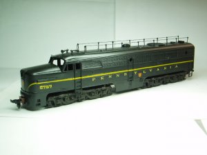

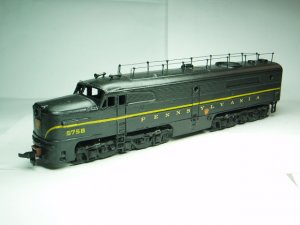

    Lindsay V motor
    Billl like I said I have two of them but they are in two Lindsay PA1's. And they are running. I can't help myself but I'll check with a friend to see if he has a spare.
    Here they are and a drive.

    Thanks guys.
    Once again, a forum has lit a fire under my dead *** and caused me to get something done.
    I took the motor from my stubby, which was laying on the workbench and removed and polished the business end of the brushes.
    then I took some Tuner cleaner and squirted it into the brush holes. The fluid that came out the side of the frame was blackish grey in color. it was cruddy enough I wiped it off the RR room floor (not exactly clean) so it wouldn't leave a spot.
    I assembled it, and after a little tweeking of the brush springs it runs ! The low speed of this motor is quite good , although it fairly screams at full throttle.
    I'm going to have to replace the wire for the insulated side pick ups it's down to one strand @ the solder joint at the brush spring, but it appears that the little stubby is alive again!
    I'ts going to take all my stregnth to resist trying to convert this to HOn3. It looks lie very little frame narrowing would be needed, but with my luck the wheel centers would break when I tried to press them inn on the axle.
    That is a shame, as the near scale wheel proflie would be much happier with track built to HOn3 standards.
    We have a club open house this weekend, and lots of work to do to get ready, so it may be a while before this critter goes back together, I'll report in when it is together and working.

    Glade to hear your Lindsay motor is Ok. Good luck with the conversion.
