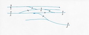

I'm over the same dillema right now. I'm definately going for Peco turnouts but don't know if I should get Electro or Insulated frogs. I'm going to cram 7 turnouts in 16"X60", so I fear that Electrofrogs might be complicated to wire because I have lots of turnouts in not a lot of space and that in one place I have 3 turnouts joined together. I really like the idea of a powered frog since I'm gonna have my LL SW1200 crawl real slow around the layout which will be DC powered. One-Loco layout with a few isolated places to park locos.
The wiring thing has me confused more than anything. You guys have lots of precise explanations, but I just can't understand them, I can't picture it in my head. Is there any tutorial with pictures (I'm a VERY visual person) out there??? (for both electro and insulated frogs)

You should be able to run either type of Peco turnout without adding DPDT switches. (Unless you have a reverse loop). The electrofrogs will require extra rail gaps beyond the frogs. Then you probably have to add extra feed wires beyond the gaps.
The gaps are required whether you use DC or DCC.
Post a track plan and we can show where the gaps and feeders go.

Magic man:
here's how I would gap and wire your layout. You need gaps where your switches make a crossover and you need to feed from the other end.
If you're just running one loco at a time, you can wire all the feeds together.
