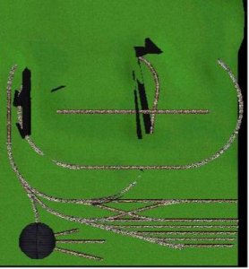

this might work it has a yard in front the city is ment to be in the center on the mountian. I did not do a double line because of time but you might be able to squezz one in. The mountian did not come out right when the center line comes under the other line the left right line should be mkore of a bridge. The back should be exposed instead of a tunnel. sort of what dan couldn't visuailize
ozzy
hmm, thanks for the help so far, i think maybe i will be better off with more room. the 4'x4' space i was thinking about is at the end of my O gauge layout, its 2 4x8 tables in an L shape. maybe i could just have one 4 x 8 for the O gauge and one for the N gauge. hate to make the O gauge any smaller tho.
