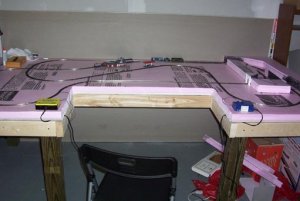

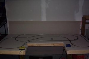

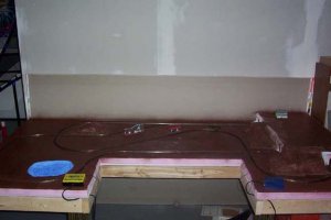

OK, the tracks are wired seperately. I ran into the same guy at the store today. I asked a few technical questions that I already knew the answer to, and he got them all wrong. Oh well, what can you do?
I am well under way now, so he are a few pics to show off the progress. Already misjudged the speed of the atlas and had a nasty collision. OOPS!

shaygetz
May 2, 2003
3,612
www.freewebs.com
That's why we're here ;) As long as you keep the two lines separate, you'll not have to worry about special wiring problems. Is that platform....drywall?

Well, as of now, I am just setting up things as I see fit, not going for an actual model. Don't give me ideas though, because that sounds real interesting. Just kidding, ideas are always welcome. I don't think the wife will let me model a real line though, she see's a pretty house, then it has to go in. A McDonald's...oh yeah, that has to go in too.
Yes it is drywall. I had 2 pieces left after a project down in the basement. I am assuming you asked because it is not common. Please dont tell me that it is a bad thing.
You are right, it isn't common. Is it a bad thing? That depends on what your ultimate plans for your layout are. If you don't have any support under the wallboard, that's a bad thing since it won't take too much pressure to crack it. Even if your layout is entirely flat, and you decide to put in some water and a bridge, it's easy with the foam, and more difficult and messy with wallboard. You always find a place where you would want to put a valley or hill, not easy with a wallboard base. When you go to balast your tracks or put down ground cover, the wallboard will soak up the moisture in the glue.
The most common material for a base is extruded foam, either the pink or blue stuff, and not the white beaded stuff. It is 1" thick and most people use one or two layers over 1/2" plywood to give it rigidity. The foam cuts nicely and is easy to shape and glue stuff to. Now you know why he asked...:wave:

Again, thanks for the info guys. Yes the drywall is supported well. It is basically a wall frame under the board. Also, the drywall was simply acting as my plywood, since I already had it. The foam is being picked up saturday. I was wondering how well the glue would stick to it, so I am glad to hear it works well on foam.
Unique...yes, bad...no ;) I do suspect those little teenie trains make quite a racket when going around the loop :D Once you put a foam sub-base on, all should be well as it will deaden the sound . Just be careful with any water based scenery as too much in one spot for too long could be a problem with sag and mildew or mold.
Tileguy
Apr 28, 2003
766
Northern Mn
Youve got a really nice start there.Wow you built that Heavy duty.Are those 4x4 legs?? 1x3's would have been plenty good LOL. Now all you need are a few pasing sidings, some industry spurs, and perhaps a small stub ended Yard.

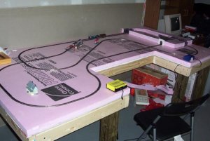

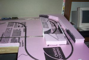

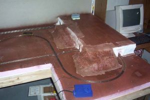

Just thought I would post my progress just to make sure you stop me before I do something irreversable. I have started my tunnels. Obviously they need building up and shaping, but I am making sure everything is done inside before I cover it up.
I built my first model house. Ahhhh, how it brought back memories. The next steps should be glueing the track down, ballasting, and laying the main roads.
Let me know if there is anything I should be doing before that.

shaygetz
May 2, 2003
3,612
www.freewebs.com
On that right side piece of foam, cut you about a 10-12" piece out of the middle and shorten that tunnel wall in the middle by half. That way you'll be able to reach in thru the back of your mountain to rerail any cars or lokeys that might (will :p ) jump the track. Other than that, welcome to the big leagues...good job :thumb:
jhoban
Jun 18, 2005
40
44
Well, I was planning on making it so th top of the hill came off for that purpose. I like your idea MUCH better. I thought long and hard about how to make the top come off and still look seemless. Glad you made the suggestion. Thanks!

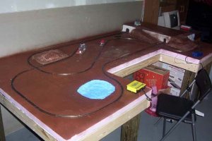

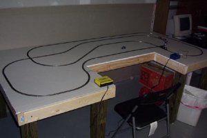

Just updated what has been done recently. I have a few questions before continueing though.
How do I go about laying grass and ground cover. I should say, how do I attach it. I was thinking simply spray glue an area, and sprinkle on what I want. However, that doesnt seem like the best approach. Any ideas would be welcome.
For the lake I was planning on doing some touch up painting and filling it with whatever product makes realistic looking water. Havent researched that a WHOLE lot yet. I did however see some topics about making ponds with mirrors or other reflective surfaces. Do I want to go that route for a lake with is about 10" wide. Again, any ideas would be welcome.
