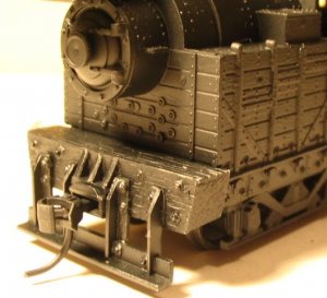

I cast my own bolts and washers for thebumper on my Climax. My model came without the part, so I had to scratch build it. That included the hardware. I made a mold out of latex casting rubber from some samples I found on the side of the Climax engine and cast them with 5-min Epoxy. Worked........well........see for yourself.

Nice work TC. But I will have to go with the Grandt Line castings too. Just don't limit yourself to what they sell as HO scale bolts. They also sell O scale ones which work well for big bolts in HO. They have a website and sell direct, I have had some problems with other places stocking them. Fred
