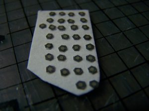

    So I first printed out two copies of the kit, one for detailing, the other for the actual shape. I also had six copies of it already printed and in storage for about five months, so I decided to use it. I cut out the nuts and bolts for the turret, and laminated them to 1mm cardboard. Since I don't have a special punching tool, I had to individually cut them out. [It was a pain :cry:] And I'll go to the hobby store to get a small punch set to get in the bolts.

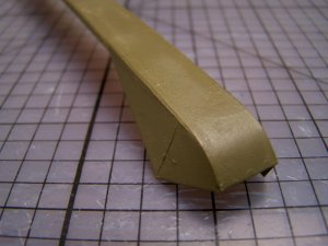

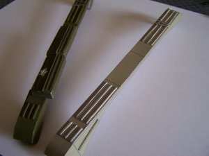

    While I was waiting to get my punch set [Which I'm still looking for] I started on the side skirts? Fenders? I'm not really sure what to call them.

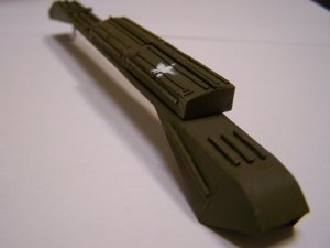

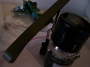

    I built the shape of it, and painted it in an olive drab color scheme. I would have gone with the same color as the kit, but I saw a pleasing representation of the Cromwell in a darkish green color, and it seemed like olive drab. Then I laminated some other pieces from the Fenders and stuck them onto the main piece. After looking at some pictures, I think I shouldn't have done that. I believe they were supposed to be recessed instead of extruding them. :rolleyes: Alas, I'll just stick with it, I think it looks alright for now. :thumb:

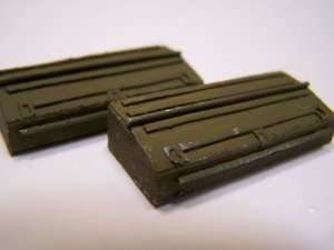

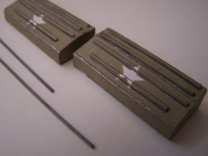

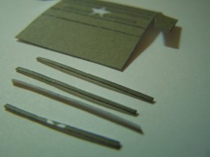

    Alright, back from working for 5 hours at this model. I had a haircut and had some pauses, so that's why it took so long :mrgreen:

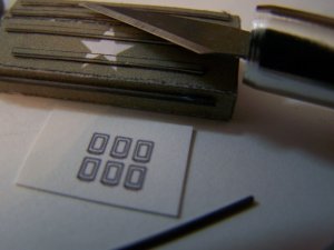

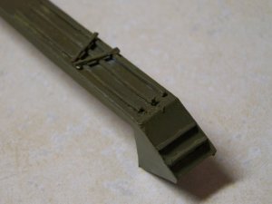

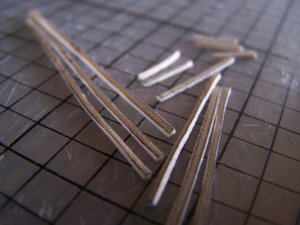

    First I used one of my copies to laminate the narrow strips of paper on the Fender box thing. [I'll have to look at the Cromwell specs later, forgive my ignorance] I used 67lb cardstock for the lamination. Then I took two .7 led rods, and used them for the front side of the box. I did a quick design lock design for the boxes, and printed them out. [It was a pain to build those locks :cry:] I glued them on and went outside.

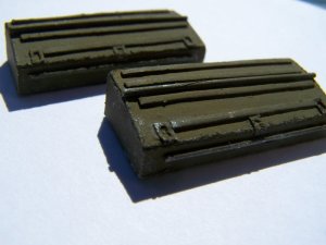

    For the paint job, I followed what I did earlier with the fender. I took my white primer, and sprayed the boxes. [I don't have a picture for that] Then I used olive drab to coat it, and added some debris near the rods [sand bits] to make the weathering. Once I get the star decal on the boxes, I'll glue them onto the fender and add some gun metal and rust.
    I still have yet to complete the decal for the star. I did an experiment earlier, and I failed to get a star to my liking. It turned out to be a blob :cry: So, I'll use another copy of the boxes and remove the star piece for my decal. I should have another update later this afternoon.
    As for the pictures, there are two different photos of the finished painted boxes, outside and inside photography. I really think the indoor shot of the box really brings out the dirt, but the outdoor photo of the entire piece looked great as well. :rolleyes:

    The "bolts" on the turret of the Cromwell aren't simple hex shapes but are conical. The Cromwell was uparmoured early in development - hex bolt heads would have been dangerous since incoming rounds could tear off the bolt head and propel the bolt shaft into the tank. Similar things happened with riveted tanks. The conical bolt head was supposed to deflect rounds so this didn't happen.

    Charlie: Thanks for the note, I'll add some conical pieces onto the hex shapes once I get to the turret. I'm still not sure how I'm gonna mold 31 conical pieces :cry: I guess I'll just use some putty for it. Or I'll design some real quick, but I'm still not sure yet.

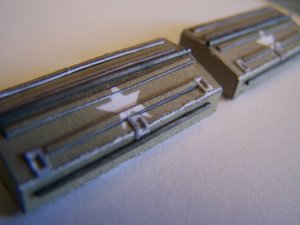

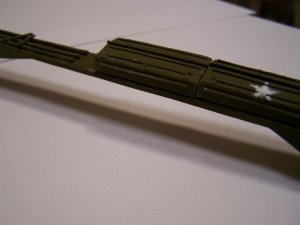

    I sprayed the star on, [It took way longer than I expected.] I might redo it, but I think it looks alright for the moment. I haven't glued on the boxes to the fender yet, because I need a perfect fit onto the body of the Cromwell. So tonight I'll build the basic shape of the body, and fit the fender on. More updates tomorrow :thumb:
    In fact, I might spray another coat onto the furthest box, since it seems to me it has a lighter shade of Olive drab compared to the rest of the model so far.

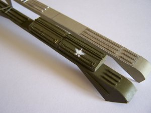

    Sorry about the wait guys, yesterday was Easter over here, and I had some occasions to attend to :mrgreen: But now I'm back on the Cromwell

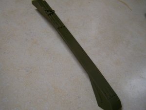

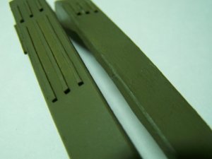

    So I worked onto the second fender, I laminated the strips with 1mm cardboard, and glued them on. Later today I plan to paint the fender piece, and get the box done as well.
    The pictures show the difference in hues against the printed Cromwell and the painted olive drab varient. I personally like the olive drab, but...

    As to the conical "bolts", you might want to trim them out of a small dowel.

    You can also try Home Depot or Lowes for the dowels.
    They have some pretty small diameters available.

    Alright, I finished painting the left fender. Sorry for the bad pictures, I painted the fender 2 hours ago, and took pictures about 15 minutes ago. By then, the wind was howling, and the sunlight flashed by. So I'll wait till tomorrow to get a better picture of the color variation.
    I must say, my second fender, looks more smoother than my first one. That is an extremely huge problem for me. The color levels in the olive drab is more lighter in the left fender. So tomorrow, I'll need to spray in another coat, however, I need to get the same darkness in both fenders, or it'll the left fender will stick out like a sore thumb.

    The fenders look good. Uneven paint, smoother vs. the other less smooth? In the field things were never quite symetrical and the equipment looked very used and patched. I wouldn't worry too much about the texture match unless it's glaring.

    As for the bolts, another method may be to make small cones, glue to a thick cardboard hexagon, and remove excess paper where they meet.
