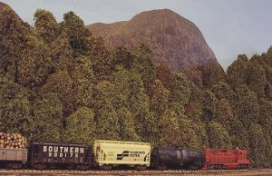

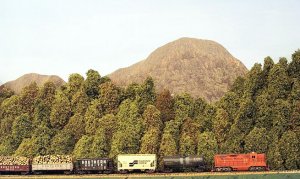

Hi Tyson, great effect as there is only 4" space behind, good use of the trees.
Shamus
Tyson Rayles
Sep 25, 2001
4,310
Poverty Acres, North Carolina
Thanks guys! :) Rich the trees are polyfiber fill from Woodland Scenics. I spray the fiber with automotive primers (black, dk. brown and rust, 1 color per tree of course) then dip them in a bag of various shades of WS coarse ground foam. They are "planted" on toothpicks. I use auto primer because its cheap, dries flat and dries quick. I do touch-ups with cheap hairspray.

Pete I prefer foreground trees like you make, but as you know that can be quite time consuming! I use foreground trees where they stand alone or are somewhat scattered. For the other 1,500 or so I'll stick with this method so I have a CHANCE of getting the layout done. Catt just as soon as I get mine done I'll be there! :D
sumpter250
multiscale modelbuilder
Jan 19, 2002
3,073
80
Vernon Hills, Illinois
Tyson,
The trees I build for the modules take from 1 to 4 hours each to build(one of the pines took 8 hours to complete). The forest on the modules has grown steadily over a fifteen year period. Because I have only 24" depth of scene, on public display, I chose to "model the forest". For a layout, especially for background, I'd use the same technique you've used, and save myself tons of time.
