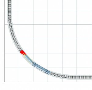

- With the smallest available turn radius of 22.5", you will need at least a 30" x 30" long area to turn 90 degrees. The picture below has 6" grid lines using 22.5" radius curves that are 14.75" long:
