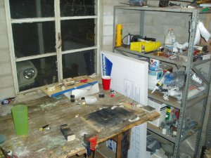

    Resolution 1: Clean up the workshop. Okay, it's not perfect, but you should have seen it before :eek:

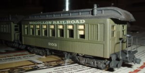

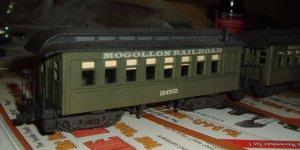

    Resolution 3: Finish up those passenger cars I have been working on for a year. These are the old-style Model Die Casting 30' overton cars that I picked up at a train show for cheap. I narrowed them and mounted them on some old HOn3 kemptron trucks. The windows are plastic packaging from some flashlights that I gave my nephews for christmas. The lettering is custom decals printed on a 3 buck HP printer I picked up at a thrift store. The clerestory windows are the same clear plastic, frosted with dullcote. The "tarpaper" roof I made using Malcom Furlow's technique of painting the roof black and laying toilet tissue strips in the wet paint, and then painting again. And the window shades are resume paper.
    Kevin

    Good luck with your resolutions. Is that a 65 Mustang outside the window?
  5. nachoman
    nachoman Guest
    yep. March 1, 1965 build date.

    Too funny. As I looked at the first picture, my first thought was the same as CJTK's - "Is that a 65 mustang in the window?".

    Those coaches are :thumb: beeyooteefulll. Man that is some nice work!

    Those coaches are indeed sweet. I have a G&D 30' combine I'm doing a similar thing to.
