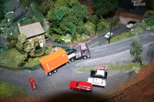

Dear All
I have started putting in water features using hot melt glue over sand which was PVA glued onto the hillside channels in West Highlands we have streams of water everywhere 78 dry days at my house in 2005!!
So our lay out needs to have Lochs/lakes and rivers and plenty of em.
I have painted the outlines in haphazardly with a brush to leave indications of rough locations.
Last night I prepared a Loch bed using sand technique.
Do you think the water fall feature clear no nails would work if poured over the place I need lots or would I try laying hot melt glue sticks on the water bed and try melting with a hot air gun on full heat.
We want to get as real an indication as possible NAZGUL waterfall tutorial was really impressive.
Lochs in Scotland are deep black or dark peaty brown not bright blue and the reflexions from the clear water are incredible so thought of taking pictures of lay out in parts and pouring the material over the pictures to give the mirror reflexion..
All trials and ideas greatly received we try to make up things rather than buy in.
The viaduct is next balsa wood card board and body filler. Will post picture when done.
Happy constructing John & Dougs

I'm not seeing loch's and lakes in this picture,I'd also delete the big truck as it kinda overloads the scene..The telephone booth also looks to be in a dangerous spot.

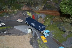

The lay out is in it's indication stage at moment nothing is finished we wanted to get the basic shape going first. Telephone box isn't painted or finished properly and had been plopped there to give an indication of scale for the hedge which still needs finishing.
Here's a picture of where we want the water to go. Through the fank under the railway, under the road bridge and into the loch.
On one roads I drive we have 3inches between the rear trailer and the bridge. Thats with the bumper almost scraping the wall on the front near side. we have to drop the suspension to get under the bridges with the front of the trailer then raise 1/2 way through to get the back under. There is 1.2 inch either side of the top of trailer and the bridge. keeps the mind focused and scares the hell out of the tourists.
Thanks for your feed back we need lots of it so we can get things right all thoughts are well received.
Cheers mate any ideas on the water though.
Kind Regards JB

I'd use clear drying resin, but you will need to ventilate the room well, otherwise you may pass out. Use Scotch tape, twisted to make small waterfalls if you have any, then run the resin over the tape.
I use (and sell) a product called Magic Water, No harmfull vapors and gives a great effect!
David
The sand is not dark enough for a realistic lake bottom, and it will show through a transparent material. Probably should paint it black. Harold Minky, I think, was trying reflective mylar balloon material which looked pretty dang good. Many just use a shiny varnish over a darker base without attempting the transparent look which often does not present in nature. Stripes' Magic Water looks excellent also!!
