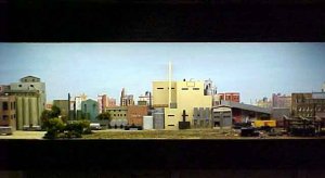

I use 48" florescent tubes to light my layout...I used 1/8" masonite to make the facia, & used the same material to make a valance at the top to hide the lighting...I painted facia & valance black...I thought this really mag=de the modeled scene stand out...kind of like looking through a window...
The good thing about masonite is that it can be curved to follow the line of your layout...

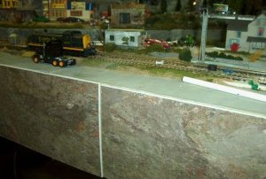

To decorate my facia I use self adhesive vinyl floor tile. I use mock rock ones and they look cool. Fairly inexpensive too. FRED
