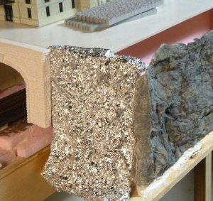

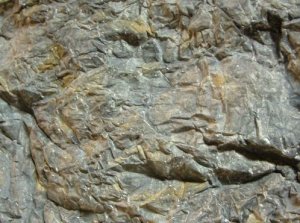

Has anyone used Alumimum fiol to cast rock face?
I think it works better then the castings I bought. Just crinkel the foil un-crinkel, not too much, shape it to fit the space. Leave the edges longer so you can fold them to make a lip.
spray with Pam, pour in the plaster and vola!
I used Plaster of Paris, which is very heavy and tends to flaten out the foil.

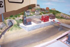

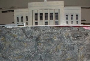

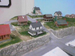

I do this but I lay the crinkled foil flat in the bottom of a bread pan. Then I pour the hydro cal in and let it harden. As soon as I can pull it out without it breaking, I carve either rocks or bricks into the face for N scale retaining walls. It takes a little work but well worth the effect. It is kind of hard to tell as I did not take these pictures with that in mind and also the first picture was taken with a cell phone but hopefully you can get the idea. Also keep in mind that these were taken "in progress."

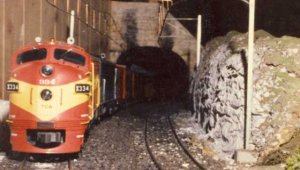

Crumpling aluminum foil has the advantage that you can adapt to your modeling scale. The more you crumple it, open it and crumple it again, the finer are the wrinkles and stone faces. So for N scale you just crumple it some more than for 0 scale.
IMO, crumpled foil works best for rock walls that (on the prototype) were supposedly blasted away. Here is an example I did long ago for an 0 scale layout.
(I also used it for lining the inside of rock tunels - sorry, I have no pics of that. But it looked good.)
