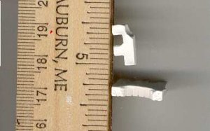

REVEIW of BRICK MOLDS
I received the set of 6 brick molds Friday. My first impression upon opening the package was the pieces are small and the bricks are big. All dimensions are approximates using a ruler, so here goes. The castings are 1/8 inch thick and 1 ¼ square. The people doors are 7 foot by 3 foot, pretty good. The individual “bricks” are 5X9. I realize they are sold as OO, but the bricks are closer to O in height and HO in length. The thin size of the castings means they are brittle and easily broken upon demolding. This means slow casting cycles waiting for the plaster to get hard hard. The window and door sections are really fragile and hard to demold; they want to stick on the fine detail. I have broken about 1/3 of the door/windows and about ½ of the really small trim pieces so far. The interlocks seem to fit each other good, but regrettably all the pieces don’t seem to be the same size (see picture). The plus is there are lots of different pieces and I should be able to build some interesting structures if I can ever get enough good pieces cast. The pieces have nice sharp lines, good details, and are fairly flat. The mortar lines are extra deep which will help hide the seams. Multiple stories will require extra work to hide the joints. It takes 1 cup of plaster mix to fill all 6 molds. On the whole I’m not happy with them. I’m sure I can build with them, but it’s not as easy I imagined. It’s one of them wanting is better than having things. Maybe European bricks are different than North American one? I give them a C-. I have buyer remorse.:cry:

rebuttal
With all respect to Russ, resin would prob work good, BUT the first sentences in their Product Overveiw reads "Linka is a system of reusable rubber moulds that are used to cast interlocking plaster pieces". That's what I wanted, not resin molds. Option 3 is to talk user philip into making and selling us some molds. I'm going to use these molds because I spent $65 on them. DASH

I'm very sorry you had such a difficult time with our moulds-especially the first time you used them. There are some tips which should produce much greater results.
First, regular plaster of paris (POP) is very brittle, shrinks substantially on drying, and is generally not recommended (although some high-grade types are OK). Instead, try a harder plaster such as Herculite #2 or Hydrocal. You can also use any number of harder, denser, dental plasters too. Dental plasters shrink less and are very hard.
Second, allow a few hours for your castings to dry-the longer the better. I allow mine to dry for 12-18 hours or more. Once completely dry, the pieces can be removed much, much more easily. A common mistake is removing them too soon. Although you can remove them in about an hour, the castings are soft and delicate. Allowing them to "dry up" lets them be at their strongest.
Third, if you are still having trouble removing the pieces, put a small amount of dishwashing liquid in each cavity before you add your plaster. This will help with de-moulding.
Fourth, you mentioned that your pieces are different sizes. Could you elaborate on that? If you are using POP or some other plaster that shrinks, it may appear as though the pieces are different sizes. They are actually all carved to the same dimensions so there will not be a discrepency in their size. Please check the manufacturer's shrinkage claims for your plaster.
Finally, if you are still unsatisfied, please contact me. Linka World has a very generous returns policy. The last thing I want is for anyone to be unhappy because of my products. I think we do a fair job at describing our moulds and the steps involved in casting with Plaster on our Website. Nevertheless, working with plaster (or resin) does involve some extra work that a lot of folks are not prepared for. Please let me know if I can be of further assistance.

Fred_M
First, I’m sorry you didn’t like my review, but I was being nice. The mold that is causing the most problems isn’t square. This is difficult to see in pictures but it causes the parts cast in it to droop at one end. This can be seen in the original posting I made and can be seen in the mold picture below. Also, the parts vary slightly in overall height as can be seen in the original picture. All were cast in the same lot.
