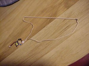

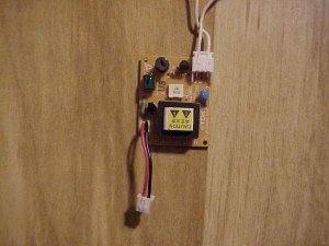

What you are looking at is two pictures of the flor. light bar out of an old scanner. When your scanner dies, (meaning that it won't scan correctly, but the lamp still lights), you can pull the lamp and the transformer board out to use
for custom lighting. The voltage that is applied to the board is 5 volts dc and it lights up just fine. So let your mind run wild. Mine is! :eek: Now, I know that I need another 1/2 dozen more lights to complete what's going through my mind!!!!!

Here's an idea....... If you have a metro type layout w/any tall buildings, stand that bad boy up in the center, and light the building up. You might need to surround it in something to diffuse it since every scanner i've seen puts out an abundance of white light. Just an idea. :D

Doc - Good idea! Your right about the aundance of light, I thought about that also and found plastic cylinders about 1/2 inch in dia. and 12 inches long at hobby lobby, they had transparent Red and Amber. For control of white light, I thought about the Amber sleve and spray paint white on it with only a thin coat at a time till I reached
the brightness that I wanted.
