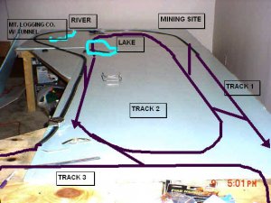

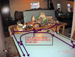

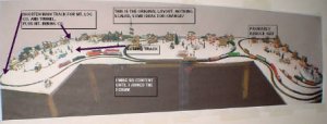

new layout maybe with pix
Well, maybe you will be able to make heads or tails of my layout and what I want to do as well as what I can do?
AS you see I have 3 tracks. I want to connect them all? But if I do can each track run independently of the others. If so,being more than an extreme newbie, am I biting off more than I can chew?
Now, when I connect the tracks can I use that same switch to go to one track and back to the original track or must I have another switch?
Please take a look and humor this old man - my wife is not -plus put me on a strict budget!!

Having a bunch of inter connected loops is ok if that is what you want to do. For me, I just don't care for the idea of being able to take a shot cut just because I threw a couple of switches. I like to have a purpose for each peice of track I install on a layout. That is just my opinion.

I like what you have done!
I have noticed that many RR's are building their layouts as you have done with the middle narrow and the ends wider.
is there a benefit to that tyoe compapred to mine?
My imagination runs wild (what I have left). Want to put a couple of mountains (maybe even 3). As noted, one with a logging camp, one mining and last one near mt. side of track 2 w/ a tunnel. maybe ski resort or homes. Lots of grandeous ideas, I know.
On retirement income and a wife that thinks I'm nuts for starting at this age, it is an uphill battle.
But, I'm having fun!!!!!!!!!!!
Paul
Russ Bellinis
Feb 13, 2003
4,501
Lakewood, Ca.
The main advantage of using the large ends with a narrowed middle is to allow easy access to all of the railroad in case of a derail. The large parts at the ends allow for return loops. The layout type is referred to as a "dog bone."
