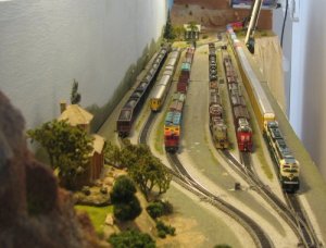

I know I am the one that told you to add more track to your staging area, but now I am nervous about how much track you have in the area that you have indicated. Below is a picture of our club's Bend Module yard. It has 6 tracks in a one foot wide area and it can be a little difficult to get your fingers around cars without touching the other lines. From your drawings it looks like you have 9 tracks in less than a foot. You might want to lay out track and just test if you have enough room.

Oh yeah, I'm diffinently going to test lay all these staging track for that very reason. Heck, I should probably do that today since I have a box of flex track.
The plan is more of guide cause I've always changed something in past layouts due to "real-world" space constraints.
I call aways expand the staging up to 15" as well (width of main level) if needed, and I have a feeling I will, heh.
Thanks again for info. This is why I like having progress/track plan threads. There's always something(s) I didn't think of I'm sure another set eyes will :)
